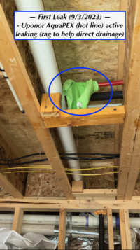

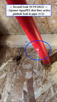

Hi Guys, finally had the time to review all the posts here. I have to apologize that I hadn't read everything before posting a redundant link to that Integrity Plumbing video. At any rate, here's the situation on my end.
We've had 2x leaks over the course of 3 weeks. The first resulted in some substantial water loss, but unfinished basement, exposed pipe, no dry wall or demolition costs, just a big outpouring of community support w/ dehumidifiers and fans. Well, this week (reason for my original post of course) discovered a second leak, still in the basement and still no damages. So, lucky us I guess.
At any rate, I've been researching the lawsuits, the color chemical issue with the Uponor AquaPEX Type A manufactured between '15-'18 and that's what we have throughout the house. I've contacted our homeowners insurance and they won't cover anything preventative like repiping the house, so nothing doing there until I have actual damages. Oh, and don't make the mistake of filing a claim, as that filing regardless of dollars associated is a GOTCHA and goes against your overall insurability simply as a person that files multiple claims. In this case, I filed 2 claims one for the leak on 9/3/2023 and one for the leak on 9/19/2023 because I didn't know there was a detriment to doing that, nor did I understand that insurance only activates once something is actually damaged.
At this stage I have contact with a lawyer here in Atlanta who is researching the class actions and is to get back to me with a point of contact if there are any class actions to participate in. Also, he's researching whether or not there's any funds that have been setup as a result of other lawsuits specific to the Uponor failures. More to follow there. Obviously I'm new to this forum, so I'd love to share specific contacts, names, phone numbers, but didn't know if that was a fauxpax becuase no one seems to share that information. I'd love to share everything if it's helpful. I know some folks here are questioning the validity of the statements being made here, so who cares, let's share some phone numbers and get on with finding solutions.
Furthermore, I spoke with a local repipe plumber who says to file a claim w/ Uponor and see how that goes, and that he'd be glad to repipe my house with Uponor PEX type A for $10k including drywall patches and paint (in those areas). But to that I say WHOA! fool me once w/ Uponor, shame on me! Fool me twice, and I'm just not down with that. So, now I'm researching pipe materials -- has PEX been around long enough to have all the data, or will we continue to see multiple brands of PEX come under the gun? -- see: https://www.classaction.org/pex-plumbing-lawsuit -- I DON'T KNOW, but I'm not sure I want to find out there's another issue 7 years from now w/ PEX.
So, do I choose cPVC and repipe the entire house (both hot & cold) for $15k, which is what another plumber is quoting? I DON'T KNOW. On the one hand, it sounds like my only choice is to file a warranty claim w/ Uponor as that could result in repiping at their expense, but on what BS timeline is that happening? 4-6 Weeks to test things? Great, so what in the meantime? Spot-fix things and hope none of the leaks happen within the walls? Sounds unintelligent. We've all discovered the common problem Uponor AquaPEX type A installed between 2016 to 2018 -- so what are we to do? Address the elephant and repipe the house with something other than Uponor PEX.
But at own expense?
Seems sad. I don't have $15k to spend on getting me back to the exact same spot while there's a 25yr warranty that covers exactly this issue, but again if I go the Uponor Claims route, then what -- wait months without hot water (showers at neighbors, etc) then repipe the house again with Uponor? DANG. Just don't know.
At any rate, here are photos for the non-believers and for the other me's out there.
PS: I live in East Cobb, which apparently does have bad water treatment, so would a Aquasense water filter ($1k) be a good investment regardless of what I do?
Why those years? This is the first I've heard about a certain time window of Uponor pipe failures.
I wouldn't. CPVC is known to get brittle, particularly the hot side. Nothing like turning off your hot water valve and have the pipe snap in the wall... If you go that way, make sure your valves are mounted to backing boards or studs so the pipe doesn't take the stress.
That's a big problem. I don't know if Uponor drags their feet on claims hoping you repipe on your own which gets them off the hook (not counting any lawsuits of course). I also don't know (and maybe someone with more insurance knowledge can answer) is that if you've already contacted your insurance and they know you have defective pipes, can the insurance deny any collateral damage that happens in the future??
For all anyone knows (and Uponor isn't saying either way), water quality may not be the failure mechanism despite what Joe Ludlow says. It could be water, could be UV exposure, could be a bad batch (2015-2018?), or it could be a combination of all three which might explain the overall low incidence of Uponor pipe failure.
Of course, there's nothing wrong with filtering your water anyway. Quality of life and so forth.
Regarding your next move on repiping, that's a tough one. I have to admit that if I had a Uponor issue like you have, I would not be happy repiping with Uponor unless Uponor said in no uncertain terms they had a bad batch and the problem is fixed.
Put a gun to my head and I'd go with either PE-RT or PEX B (both expandable).

Hi John, thanks very much for your notes. I'm getting scared away from the cPVC for sure. Though I wonder if there's any way to mitigate the brittle problem by insulating or through the use of our recirculation pump?
I'm brand new to this world of piping / repiping / etc and I just wonder if all PEX is going to start failing more as the usage, years, and data comes through. As I understand it, PEX has been used regularly since the 1990s, so maybe that's been plenty of time to recognize product-wide failures. I don't suspect there's any one pipe that's the clear winner? -- perhaps Copper L -- but I'm not a millionaire.
So, I'm coming back to PEX, certainly still fearful of Uponor. But why the recommend of PEX Type B vs the PEX Type A? I'm seeing that Type B is perhaps easier to work with, but that Type A might have less restrictive flow because of how Type A is expanded between connections.
I'm sort of at that point in my discovery period where I'm back to square one, a bit, in not knowing the best direction to take. I say that, though I do suspect I'll go with PEX as all the reviews are generally positive around the web. Just don't want to come back here in 7yrs with similar issues. Though maybe by repiping with the new PEX will solve my issue and allay my concerns. It was a bad batch from a reputable manufacturer.
I guess I'll need to start the claims process w/ Uponor and just ride it out, because at the end of that road might be the possibility of them covering the costs to repipe (even if it was with their product)?
Thanks so much for your time here!
