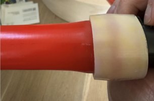

New construction, 3 years old. First leak happened 11 months ago in the kitchen. You can see in the photos that both sides of the elbow have a hairline break near the fitting. Second leak happened a few days ago very close to the first leak, but in a T.
Some plumbers who came to inspect the issue hypothesized that they were exposed to UV light. However, I recently came across the class action lawsuit against Uponor colored PEX pipes. Do these look like the typical Uponor PEX failures mentioned in the lawsuit? Should we repipe the home?

Got a really nice close-up of the recent pipe break waiting to be fixed. What's up with all these micro fractures near the fitting?

that photo close up matches exactly the photos I have posted of damage.

Yes, one leak can be an aberration, but two leaks means your pipe isn't compatible with your home and and three years in service has aged by a factor of at least ten. Your closeup pic shows pipe starting to literally fall apart.
But here's where it gets ugly - if you want Uponor to pay for the repipe, then you have to put the same crap back in. I wouldn't be able to sleep knowing I might be getting a leak in my kitchen ceiling while I'm sleeping or out for the day.
Before anyone says the colored pipe was recalled - it wasn't - they still sell it and the white pipe has also shown the same propensity for short life as the red and blue. Since Uponor doesn't know what's causing the failures that do happen, there's no way of knowing if any currently produced Uponor is any better than your three year old (three years old!!!) pipe .

Finally extracted the bad pipe. The longer side of the T was leaking, the shorter side had something brewing about to burst soon. Uponor asks for 4-7 inches of pipe on each side but, unfortunately, the plumber was not able to take more of the shorter side because the pipe was very hard to access. Hopefully they don’t deny the claim on that basis.

The reason they want a minimum of four inches is that connections made too close can leak and that four inch sample will guarantee that the expansions weren't too close and the cause of the failure.
In your case, it's clear the pipe is prematurely aged and has nothing to do with how close the expansions are, but as far as them denying the claim because the sample is too short..
