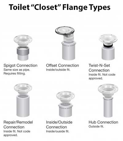

At first, I was bewildered by all the different types of closet flanges and ways they could be installed. This graphic from Home Depot really helped me understand them, and it even cites which are code compliant and which not.
My question is, if it isn't code approved, then why are they allowing one to purchase this product, or is code approval only for professionals who need to get the inspector seal of approval? In other words, if a DIY'er were to do it afterwards, would the work be just as dependable?

Your drawings show a lot of plastic rings, which can be less durable. Does not show outside compression flanges, which have some really nice attributes. Does not show Push-Tite flanges. Does not show 45 degree output flanges. And there are more... It does show some useful stuff.
I am surprised that Oatey Twist-N-Set flanges are not code approved. I am also surprised that the HD site says that, because there are things like flex tailpiece extension that I don't think I have seen that notation on. I suspect there are inside compression flanges that are code approved.
The no-glue flanges have easy do-overs and replacements. They are really nice for those who don't always get things right the first time.

Thanks for the reply Reach4. Yeah, the graphic isn't meant to be exhaustive, nor is it meant to deal with the benefits (steel/metal to plastic) but to me, it has the key terms of the main flange types. I'd be happy to make up a graphic to each and every type if you can supply me with links, and what each variation is called (spigot, offset, etc.). It would benefit me as well.

Reach4, this is my very rough beginning graphic. In looking at all the different types, it occurred to me that there were three basic types of connections being made. Inside (the smaller flange connection goes inside the pipe), Same size (the inner flange size is the same as the size of the pipe), and Outside (the larger flange envelops the pipe).
It seems pretty obvious when placed in a graphic like this. I haven't tried to capture all the different materials that make up the flanges (PVC, ABS, Cast iron). That could be added in the space below. I'd also like to in some way add a graphic for how "approved" by plumbers certain methods are. Thumbs up would be approved by most. Thumbs sideways is "meh". Thumbs down, frowned on.
Once I get some feedback, I can add "not code approved" where necessary.
Do you think this is worth continuing?

Looks useful to me. Maybe "Same size fit" could be same size as pipe, or something? Or maybe better as you have it.
For outside, I would add outside compression, such as Code Blue.
If you wanted to expand it, there are 45 degree spigot and hub, but that might overly complicate it.

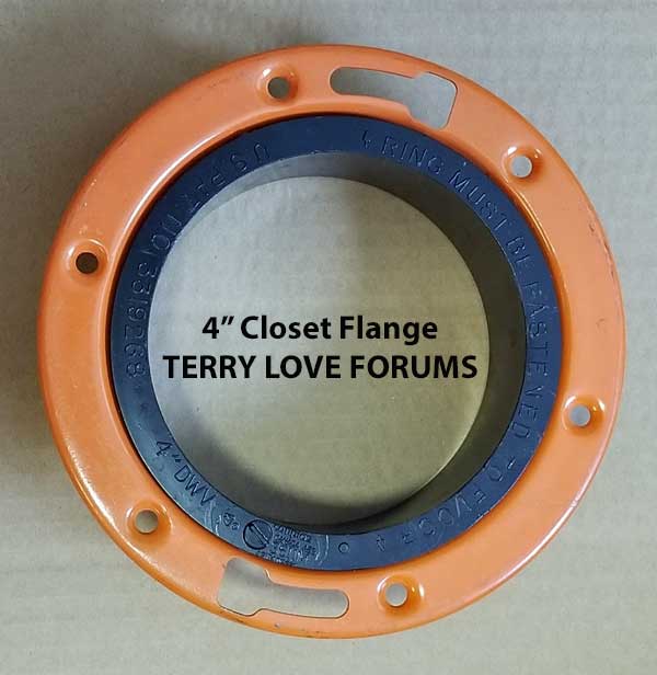

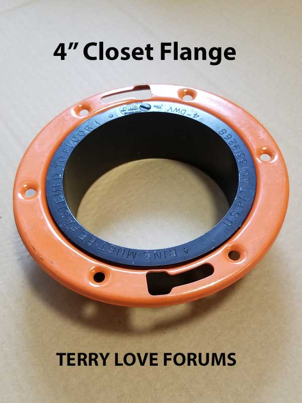

Question: do the plastic closet flanges with metal rings have a plastic groove that the metal fits into, and the split closet flanges can fit into that same groove if the metal rots away?
3,481
Yes, the groove fits the metal ring, which is also where the proper replacement rings fit in.

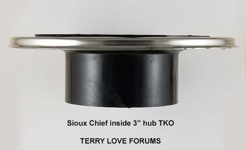

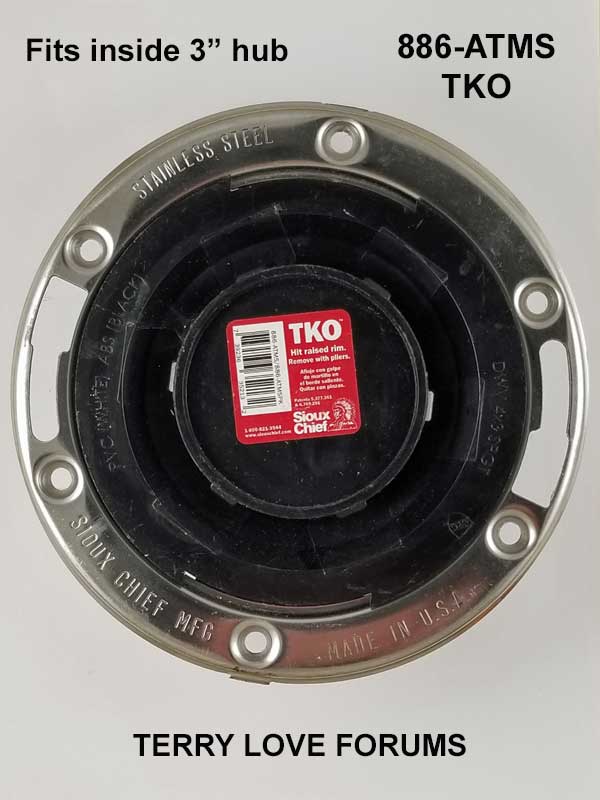

Some inside closet flanges have a bevel (fillet) that prevents sitting on a dead-level 4 inch pipe. https://terrylove.com/forums/index....-fully-insert-into-soil-pipe-solutions.90840/ describes that, tho the pipe there actually sat proud of the floor.
I suspect that that is Oatey's term for a flange that will fit. This is a Sioux Chief
884-PTM, that I think would fit, but they don't use that feature in the title.
I may be wrong on that term, but that is my guess.

Dumb names for sure and a lot of confusion around on closet rings for sure. I haven't tried the Out of level closet flange yet. I think as someone else mentioned "level fit " means the bottom will go down all the way into a fitting
