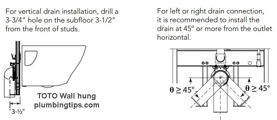

I am installing a wall hung toilet in my basement. The existing main stack is several feet away. To install the toilet where I'd like, the toilet drain will need to run horizontal (nominal fall) to the main stack. Question is, will the toilet flush properly with the drain exiting the back of the toilet, turning 90 degrees to horziontal? Has anyone seen a similar situation? If this will not work, what is the minimum angle for the toilet drain? The installation manual wasn't much help.

if you're gonig from vertical to horizontal, use a LONG SWEEP 90. If you don't have room for a long sweep 90, roll your short 90 out at 45-degrees and then straighten it back to horizontal using a 45. It'll work just fine as long as you have a vent no less than 1-1/2" in diameter

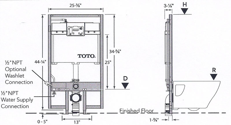

I don't have room for any of that... I posted a picture for a better view of the situation. I have seen toilet carriers with horizontal discharge... but this may be for pressure assisted toilets???
3,482

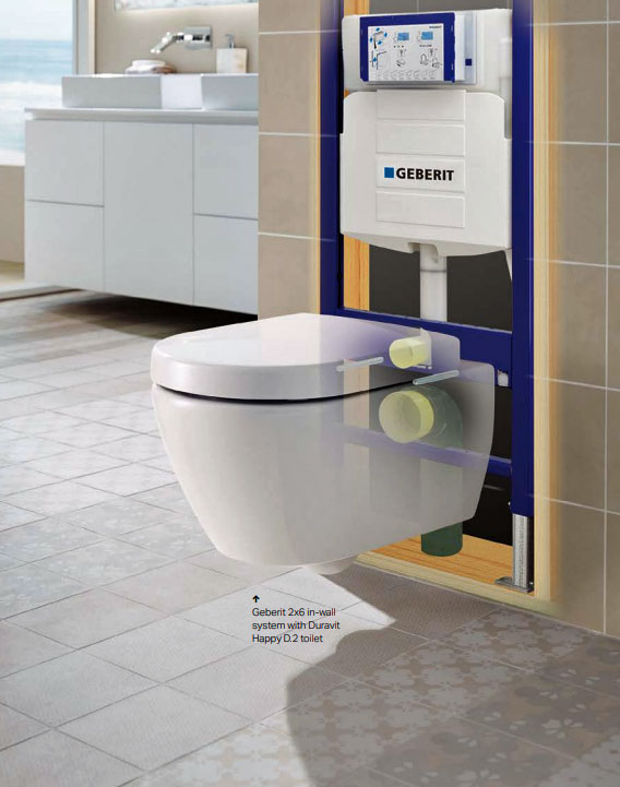

There are two types of wall hung toilets. Those that use a 4 bolt pattern like the one pictured above, and a two bolt in-wall tank carrier.
The carrier above normally roughs at 4-1/4" from the finished floor to the center of the drain. That works for wall hung toilets that use either the tank, or a Flushometer.
An in-wall tank.

Will a gravity flush toilet flush properly with a similar setup (immediately horizontal)? Toto Aquia Toilet on Grohe Carrier.
DeereAdam
charlotte nc
Awesome... that is the information I was looking for. At least I know my constraints now. I really appreciate your help Terry and Michael!
