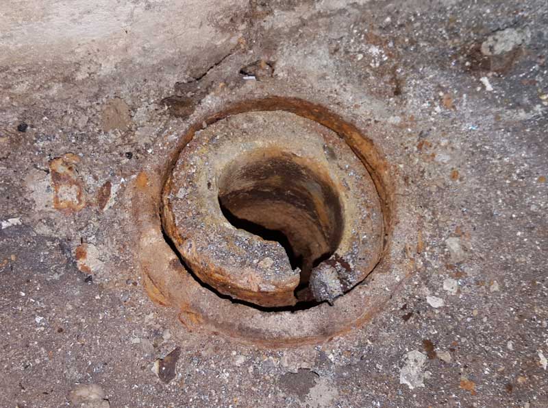

Here is a Lake Hills home from 1960 with the old galvanized trap and standpipe, which was also flooding. At the concrete level I found a 2" cast iron hub which allowed me to use a rubber bushing to transistion to ABS.

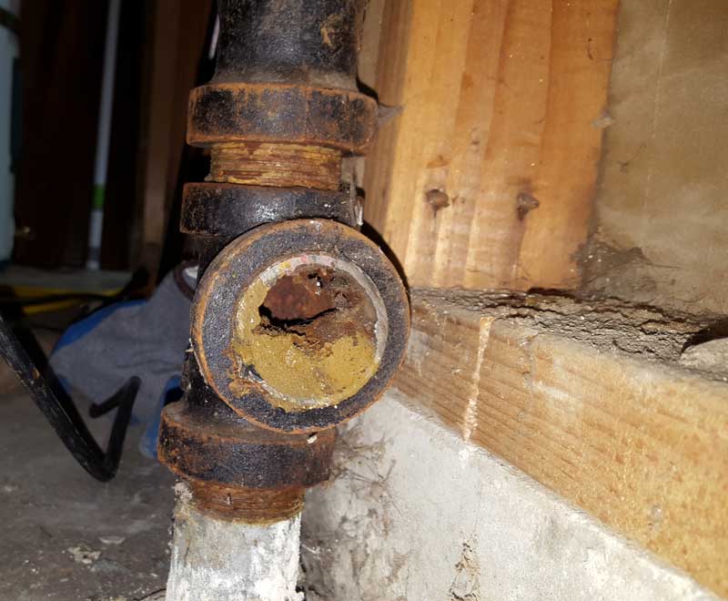

Just a little space at the top where the washer dropped into the santee.
The pipe gets cut out, and then wrestled out of the lead packing. The packing I pry out.

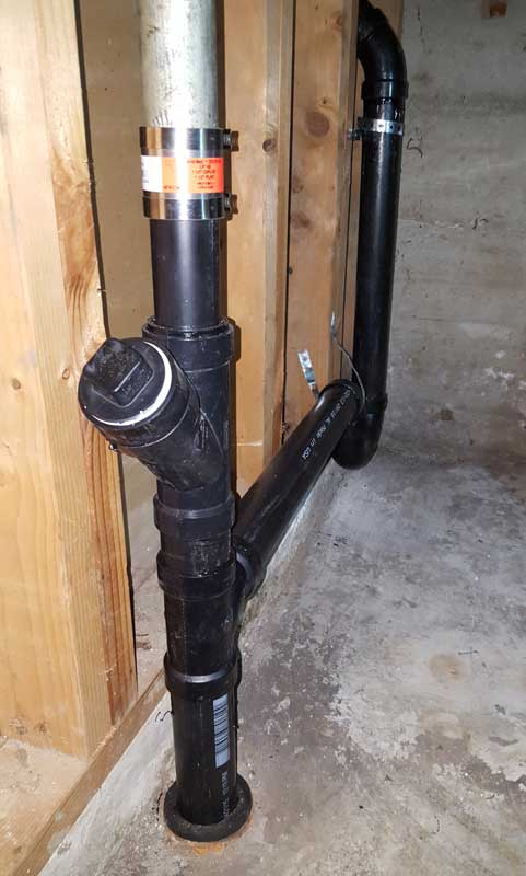

New rubber bush, and a Mission coupling where the two sections of 1.5" meet on the vent.

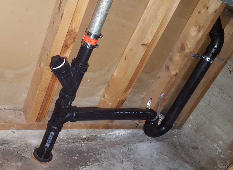

Now it's a 2" p-trap and standpipe.
Nice space under the stairs to make the changes.
