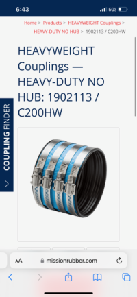

tldr: Would connecting all the DWV drain branches to the home main drain line with heavy duty four strap no-hub couplings(like shown in attached photo) make the DWV system more resistant to damage from earthquake movement?
Friends, we changed to a bigger front load clothes washer and been having an overflowing drain standpipe on and off. The water softener also drains to this laundry drain standpipe, and the salty rinse water can’t be helping. Resorted to some temporary solutions, but want to ask for some feedback.
I have 2” and 3” metal pipes in the crawl(and I mean, crawl) space. Can anyone identify the type of pipe material from the pictures? If I’m not mistaken, they look like cast iron fittings on galvanized pipes. Are these worth keeping if they are not problematic or will they become problematic?
I’m in Southern California, an earthquake prone area. Initially, I was thinking to only replace about 10ft of laundry drain branch with 2” ABS and use a no-hub coupling to connect to the existing metal drain pipe near the wye. But it got me thinking:
If I replaced all the DWV pipes with ABS, would connecting all the new branches with heavy duty four strap no hubs make the DWV system more resistant to damage from earthquake movement? And easier just to remove and replace branches as necessary? It seems like some commercial DWV is done this way, though it’s also not in a crawlspace.

We put down 6mil visqueen plastic sheet in crawlspace AND I recommend large sheets of appliance pkg corrugated boxboard to make the work easier on the body.
2” ABS should be fine for any drain system.
I’ve been plumbing 50 years in earthquake country and never seen damage…but we love the husky 4-band if we want heavy duty connections…yet the two band are fine for any underfloor work. There are transition fittings to go from 3” cast iron to plastic. Plastic pipe should have solid hangers every 4’, not strap.
We always recommend hiring a local pro.

sure 2 inch is good for laundry . if you arent opening wall yet then put your band below the floor if you open the wall partly we often run plastic up to about flood level or to the vent even if its low and connect to the galvinized vents often those vents are in darn near perfect shape.
husky bands generally arent for cast iron to plastic. I think fernco makes a expensive multi size coupling with 4 bands personally I wouldnt seek them out some people use regular no hub bands on 2 or 1 1/2 inch plastic its not legal as far as I know. I generaly use cp 200 or 150 mission brand or a fernco equivilant .
