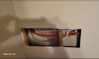

I am inquiring about the need to repipe a house. Initially, I was considering using Pex-A, which I have used in another home. However, I have recently come across lawsuits regarding Uponor Pex piping failures. This is disheartening since my previous research indicated that Uponor Pex-A was considered one of the best options available, and I had hoped it would be a durable and long-lasting piping solution.
In addition to these concerns, I have discovered that my local supplier only carries white Uponor piping. There are varying opinions on whether the issues are specific to colored piping or if all Uponor piping is affected.
Question 1: I can find Uponor, Viega, and Apollo brands near me. Uponor tends to be more expensive than the other two options. Is Uponor still considered the top choice among professionals for Pex-A repiping? Are others still using Pex-A for repiping purposes? While CPVC is an option, using Pex-A would make the repiping process much easier in this townhouse. CPVC is both more challenging to install and can become brittle over time.
Question 2: In the past, I used colored Pex-A pipes, with red for hot water and white for cold water. Are others still using colored pipes, or are they using white for both hot and cold water lines? I have heard of stripped pipes, but I haven't come across stripped white pipes.
Question 3 Should I be concerned with the Uponer Pex-A I installed? Should I be looking to join the lawsuit or try to request they send me replacing piping and fittings? What are others doing about the Uponer Pex-A they already installed?
Question 4 Uponor no longer sells their compression Manifold. What is the best manifold option? I see they have copper manifolds with ball valves. They are very expensive, but is this the best option or are the plastic manifolds acceptable.
Question 5: Are there any additional comments or issues related to Pex-A that I should be aware of? Would you recommend using a different product for the repiping, considering the concerns surrounding Uponor Pex?
Thank you for your insights and any recommendations you may have regarding this repiping project.

While it is intriguing that PEX-B is compatible with the Uponer Expansion tool, I have some concerns about its flexibility when compared to PEX-A.
One of the aspects I truly appreciated about PEX-A was its ability to run smoothly from the home run manifold to the shutoff valve without the need for additional fittings. This seamless connectivity was especially advantageous in attics, where insulation and protection against freezing are paramount.
I have attached a photo showing my installation of PEX-A, where I was able to navigate down the wall, bend it over horizontally, and then bend it back towards the fixture. This level of flexibility allowed for efficient routing. My question is whether PEX-B offers a similar degree of bendability.
Also I don't see Zurn Expandable fittings locally. I just see the crimp ones. Can you use Uponer Propex with Zurn tubing?
No, B is not as flexible as anyone's PEX A. There are probably some corners plumbed in B that will require fittings rather than bends (I would use the bend supports though with the A).
You can use Zurn B with Uponor F1960 expansion fittings.
