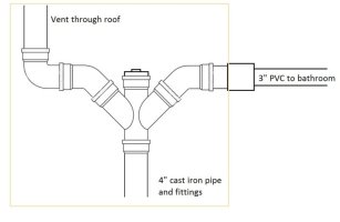

There is no existing dry vent on the lav--yet. (That's on my list too.) The only venting for these three fixtures is the stack about 5' to the left of the WC closet bend. See attached image.
Ah, that likely explains your trap sucking. The lav needs a dry vent, and then if you comply with the limit in my initial point 0, the problem should go away. Basically in the existing configuration, none of the fixtures are vented.
0) I can meet the 60" threshold from the tub trap to the wye where the lav drain joins. But does the distance from there to the lav dry vent not matter? It would be about 125" from that wye to where the lav dry vent will be installed.
No, that doesn't matter. With a wet vent the lav drain is a vent for the tub, so all that matters is the distance from the trap to the wye with that drain/wet vent. The length of the wet vent itself doesn't matter, nor the distance from the dry vent takeoff.
