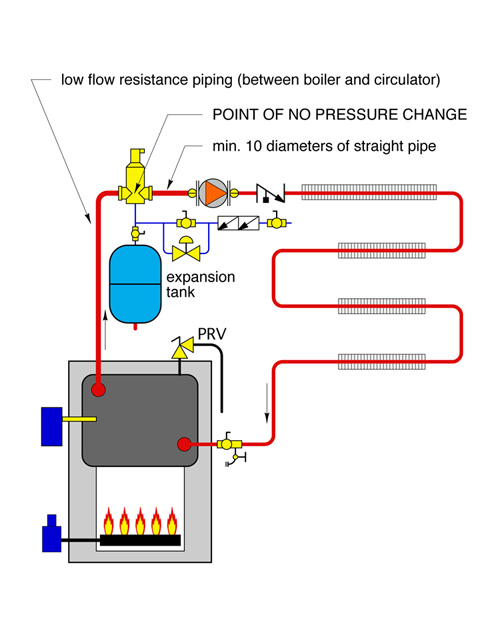

If it's swinging between 13 psi and 27 psi over the course of a space heating cycle the expansion tank either isn't big enough , or not properly pre-charged.
If "... bounces ..." means it is instantly swinging to 27 psi as soon as the circulator is running there is some restriction on the loop limiting flow.
The domestic hot water temperature rarely needs to be more than 115F to be able to deliver 110F water in a tub-fill, or 105F water to a shower. At low flow through the domistic hot water side of the combi-boiler the temperature regulation is often less precise as the burner doesn't have infinite turn d0wn range. At a given flow there is a minimum temperature rise that it can deliver.
A leak in the pipe under the slab won't suck in air, it will just cause the system pressure to drop if the system is isolated, without an auto-fill valve. If the system pressure isn't high enough to compensate for all the pressure differences created by the pumps, it can pull in air from the system vent. Typically pumping induces less than 5 psi pressure difference.
Ideally the expansion tank and vent would be on the input side of the circulation pump, with straight run of pipe between them. That allows the expansion tank to behave as a shock absorber, damping out any high frequency pressure pulses from the pump impeller, and keeps the pump from cavitating.

Thanks alot Dana these combi are relatively new for us ,I checked expansion tank it was 10 psi I will check pump pressures on both ends of the loop . And check Hi-vent I also was going to turn off feeder and see if there is a leak in the system explaining the air I really appreciate your help!

If it's a 1-2 story house, pre-charging the tank to 15 psi (when there is no pressure on the wet side), and setting the system to 13 psi is usually about right. If the tank was at 10 psi and the system set to 13-15psi (cold) there is less space in the tank for accommodating the expansion of the system water as it comes up to temperature. When completely out of space in the tank the pressure spikes quickly.
