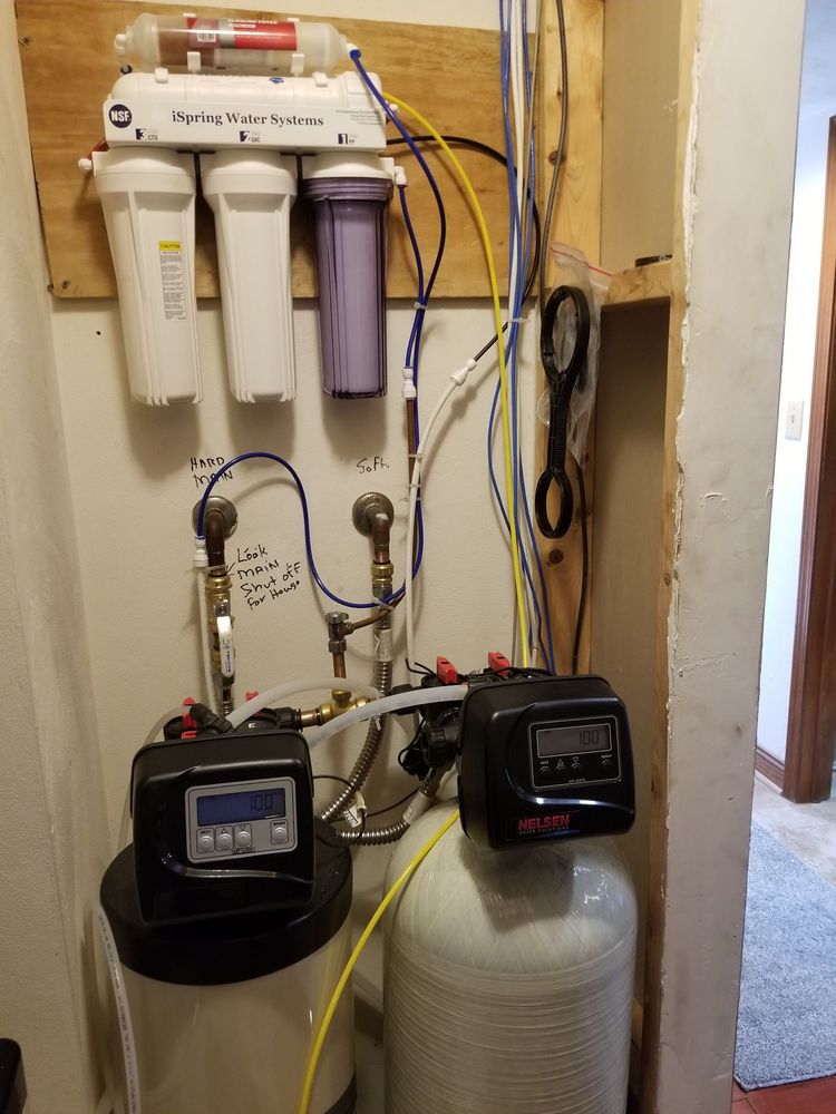

I should clarify - I paid $7500 for the softener and under sink RO from the LeverEdge/Westinghouse dealer. Purchased July 2024 - so roughly 6 months.
The additional $1500 was for the catalytic carbon tank (that I purchased from an online dealer and installed myself). I likely could have gone to a separate local dealer but am a little wary of the sales people at this point. Especially when I got a few quotes and they were between $2.4-5k for a 1.5 catalytic carbon alone.
The issue with the current company is that when I first brought up that I’m having problems, they kept singing the praises of their dealer and their company saying I’m the only person to have ever complained. My scalp and skin have suffered for 6 months. And literally as soon as I shower somewhere else, it is a relief. I don’t know what it could be. LeverEdge told me it’s a humidity change from FL to TN, and maybe that could play a part… but when I was in AZ for ten days I had zero scalp issues. They also told me I wasn't used to the water since it's a different source, which sounds like a cop out. Shouldn't soft water feel the same after treatment no matter the initial source? I do think the service Dept was genuinely trying to help at first, but I felt more like a burden than a valued customer.
Maintenance and parts can only be done by a certified dealer and I wasn’t impressed with the lack of knowledge or communication skills of this particular dealer or his team. It was my decision to steer clear and hopefully never have to see him again. It’s a big, long story but LeverEdge helped me find another dealer to help service the tank, although he is no longer actively selling the product. I could pay a service call and get him out to do the work, but I want to be well informed before I call on anyone to do anything.
I did write a google review for the Westinghouse dealer and the guy loosely threatened to sue me so instead of dealing with him, I removed it. I kept all correspondence just in case. I would rather not speak to him ever again. I would like others to know there are better options, but hopefully they find this forum! I wish I would have done more research before rushing. I knew I wanted a softener since I've had them for years. I didn't realize or understand how chlorine and/or chloramines should be treated and that tank sizing and configuration are important. A very expensive lesson learned on my part.

I can slowly see the water being a little better since the multiple regens - and will continue to pay attention to my settings. I did increase the hardness to compensate, increased the lbs of salt to 10 with 25k capacity, and have it set to regenerate every 14 days. I will see if this helps. I still get zero lather when washing my hair but as long as the water is safe and clean, I'll deal with that one day at a time and keep trying different products.

I'm not opposed to trying! But my unit is currently only a 32k grain capacity (it has a plate and then 1/2 ft3 carbon & 5 lbs kdf). If I change out the carbon & kdf and add more resin, it’ll then be a 48k.
Extra salt should show up on a TDS meter. A softener will usually make a small increase in TDS, but not a big one. I understand I used fuzzy words instead of numbers. It should also show up as a taste of salt. If you have extra salt, I would expect that to be higher right after regeneration.Could there be salt leaking into the water? Would this lead to spots on dishes/showers, the shampoo to not lather, and the dry/irritated skin?
Softeners work with ion exchange, so the calcium and magnesium are swapped for sodium.I’ve always had water softeners, but the starting water here is so different. Maybe the lack of minerals is causing issues?
Also, the spotting on dishes and shower issues are constant. I’m using way less soap and have even switched to a mild one that is supposed to be good for soft water. Is this sodium leakage? Silica?
If you mean eyeglasses, use a spray bottle of distilled water.The spots on some of the dishes will wipe off, but why do they look dirty? Most of my glasses are now scratched. This is what leads me to believe it could be sodium but also silica (or something else)... I clean the shower regularly and cannot get those spots off the glass and there are spots on the walls as well. I don't recall them being there before I added the carbon tank, so I'm at a loss on that one.
If somehow much salt were to be getting added to your water, the TDS would rise a lot. Softened water will probably be a little higher TDS than the raw water, but not a lot. Sorry... I am not prepared to quantify "a lot". A cheap (maybe under $10) TDS meter may be worthwhile.Could sodium leakage be the cause of brittle hair and weird, dry skin? If so, how do I check my system to make sure it's functioning properly? I know the softening part is working according to Hach b, but is there something I need to check to make sure the water flow, etc. is correct?

Just so I'm informed, do I ask for a 1 ft3, down flow, post fill?
2.5 bathrooms, 2 people in house, hardness somewhere between 5-10 depending on day
No notable iron or manganese, just a boatload of chlorine! but that's being handled by the 1.5 ft3 catalytic carbon
