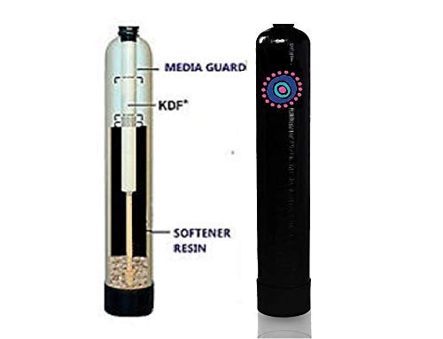

I apologize for the lengthy post. Any help is appreciated! I moved to Middle TN from North FL about 7 months ago and have been fighting the water the entire time!! I have never experienced anything like this, I have overpaid for a few different tanks, and we are still MISERABLE with the water quality! The biggest issues being our skin and hair. My hair can't get a lather and it feels like WAX and frizz no matter what I try (no poo, low poo, specially formulated shampoo, ACV rinse, etc.). I am desperate for help, answers, a real specialist and not just a "salesman"... Full disclosure, I've always had water softeners (and well water), and never any problems! I was told that I'm just "not used to the feel of the water" which may be true, but we shouldn't be having these issues.
2 people in household, 2.5 bathrooms. Sometimes family will come for a few days to visit, but never longer than that.
Here is a link to our water report/s (we are on the line and I can't get verification from municipality - but these are similar): Shelbyville and Flat Creek - both have incredibly very high chlorine levels and I *think* this may be the source of our initial issues.
A recap: we bought a system from Westinghouse (LeverEdge) in July and feel that it has never worked correctly. The first month, the brine draw didn't work. That has since been corrected. It's the "Progressive Revolution". We have the 10x44 and were told it has the 1 cu ft of resin, 1/2 cu ft of coconut carbon, and 5 lbs of KDF55. The selling point here was that this would reduce chlorine and soften the water. The demo put on by dealer said hardness was 10 or 11. He never asked to see water report and since we are not familiar with municipal water and new to the area, we trusted him. We have since sent water to test where they said it was 5GPG. I changed the settings to reflect this number. It is pre-fill and upflow - I have since learned from this forum that this is not as great as the salesman preached. We paid a small fortune for this and are stuck, so I'm hoping there's something, anything, we can do to make it work! Settings, anything!
I was able to reach out to someone on this forum and they suggested we get a 1.5 ft3 catalytic carbon auto backwashing system for the chlorine. We purchased this one through the Water eStore: HUM Catalytic Carbon - we were able to hook this up ourselves and FINALLY got the chlorine smell out of our home.
Why are we still having issues with our skin & hair? No lather, water spots on dishes, dry skin, itchy scalp and dandruff (which we have never had!), shower door spots, etc.? Sometimes we feel really dry/chalky and other times really waxy. Is there residual salt? We have had water softeners for over 10 years and this is bizarre... is something else wrong? Do we need a second carbon tank? Extend rinse times? Could the KDF be an issue for our skin? Do we need to change the water flow level from the meter to the home (is it coming out too fast?), pH level problems? Willing to try anything but need guidance.
To recap: We now have an auto backwashing 1.5 ft3 catalytic carbon tank, a 10x44 softener with 1 ft3 resin .5 ft3 coconut carbon, and 5lbs KDF55, and an RO for POU at kitchen sink.
I've changed the softener settings a few times based on results I've found here and this is what I landed on.
The brine soak period is 4 hours, these are the only other things I changed.

As for the carbon & KDF in the tank, it looks like there's a plate on the bottom and then another plate separating the media. There were all sorts of claims by the dealer about how amazing the system is, but we have not had great results.
Are you able to view the link? If not, I can try to save it as a PDF and then upload it. Also, if we are missing anything and need extra filtering, I'm happy to install other systems.
https://westinghousewatertreatment.com/progressive/inside-rev

Although mixing media within the same tank is usually not recommended, in viewing the Westinghouse PR website, at least it seems they utilize Enpress tanks equipped with the Vortech bottom screen, and a Mid-Vortech screen to keep the the carbon media separated from the softening resin.
Enpress Vortech
Unfortunately, the KDF media is shown within the same compartment as the Carbon media. Because KDF media is extremely heavy, the KDF will settle below the carbon media, exactly opposite to where it will be most effective.
Due to the weight of KDF media, the backwash flow rate required is 25-30 GPM per square foot (ft2) of cross section, so KDF located within a 10" diameter tank (0.54 ft2), would require a Backwash flow rate of between 14-16 gallons per minute. When the backwash flow rate is insufficient, the KDF media will not become lifted and reclassified during backwash, and so the KDF will become ineffective as it will eventually form a solid mass which the water will flow around instead of passing through so as to come into contact with the individual KDF granules. Because that high backwash rate would cause the carbon media to become excessively lifted so as to be backwashed out to drain, I anticipate your unit's drain flow rate (same as Backwash flow rate), will be substantially less than 14 GPM.
When KDF is utilized, the usual recommended method will be to place the KDF media within a 'Media Guard', which is a 2.5" diameter, 4-6 chamber mini tank that is fitted into and suspended within the larger media tank opening, directly below the control valve. The smaller Media Guard cross section, will require a significantly lower backwash flow rate to effectively backwash the KDF media. With the Media Guard suspended in the tank's opening, Service flow entering the tank will come into extended contact with the KDF media before passing through to the carbon media and/or softening resin below.
Although a KDF Media Guard is recommended to be backwashed at 4-4.5 GPM. the location of the Media Guard will prevent the lighter media below, from becoming backwashed out to drain.
Water treatment will not typically be fully effective unless the water has sufficient contact time with the media. To achieve sufficient contact time with each media requires the appropriate quantity of media, conditional on the diameter of the tank and expected service flow rate. For example, 1 ft3 of softening resin will typically be placed in a 9" X 48" tank, resulting in the media depth being approx 32", whereas 1 ft3 within a 10" diameter tank, will result in the resin depth being only ~24", so the water will have reduced contact with the resin, and increased hardness leakage through the resin bed will be a common result.
The limited depth of only 0.5 ft3 of carbon across a 10" tank, will provide limited contact time to remove contaminants. Although sodium hypochlorite is typically rapidly removed after only brief contact with carbon, the water report(s) specify, chlorine dioxide is utilized for disinfection, followed by the injection of polyaluminum chloride to coagulate particulates. Although those chemicals are supposedly precipitated or are filtered out before entering the distribution system, the report states an un-specified amount of un-specified residual disinfectant is added as the water enters the distribution system. As many municipal water supplies have adopted Chloramine (chlorine and ammonia) for increased residual strength and lifespan throughout large distribution systems, it is possible that chloramine is utilized as the final disinfectant.

Bannerman, I cannot thank you enough for taking the time to send this educational reply. I have learned so much from this forum and am grateful you took the time to send these details. This makes SO much sense! I wish I had known this before my move, but alas, we trust "professionals" to tell us straight. I will say, I don't think most dealers truly understand the water industry... they know the sales pitch of their product. When I bring up any of these questions, I am never met with an intelligent response and am dismissed immediately.
Here are a few follow-up replies that I hope you can help with:
1. You mentioned the additional disinfectant on my water report which may be chloramine - I have a 1.5 ft3 catalytic carbon auto backwashing tank installed prior to the softener. Is this enough to handle the disinfectant? If I need to add UV or another filter, I'm happy to do so. I am desperate for water that doesn't make me depressed.
2. With the current tank size and resin distribution, is there anything I can do to make this work? Regenerate more frequently, change to post-fill, use a higher amount of salt to regen? Or would it make sense for me to get rid of this and opt for a different configuration - perhaps a 1.5 ft3 softener only? This will result in several thousand dollars lost, so if there is a way to use the current tank, that would be ideal.
3. I think I now understand the issue with the KDF in the tank - does this need to be removed or will it cause any issues if it just stays there; knowing it is ineffective is not a problem (since we have the cat GAC) as long as there are no negative effects.
4. Could there potentially be any problems with the water heater? We did drain it to see if that would help, but we still have not taken a "normal" shower here.
I realize we are moving from a different area and from a well to municipal water, so there may be an adjustment period. However, I have visited cities with varying climates and water and never experienced these hair issues to this degree. I do know for a fact that it's the water because I go back to FL once a month for work and my skin and hair immediately change upon my first shower.

If it were me, I would remove the KDF and carbon from the softener, and flush away the carbon to recover the KDF to install in a Media Guard, placed into the Catalytic Carbon tank opening.
The final disinfectant may not be chloramine, but could be the same chlorine as utilized initially. A benefit of KDF55 is the conversion of free chlorine into harmless chloride salt and to remove heavy metals from the inflow. Also, KDF55 will inhibit algae and fungi growth and to a lesser extent, the growth of bacteria and viruses. As such, KDF55 as the initial treatment media, should reduce the load on the 1.5 catalytic Carbon media, thereby potentially extending the carbon media's lifespan, and possibly increasing the carbon's effectiveness and flow rate.
I would install 0.5 ft3 additional resin in the upper chamber of the softener, thereby increasing the total amount of resin to 1.5 ft3. While 1.5ft3 media will usually utilize a 10" X 54" media tank to provide sufficient freeboard space above the media to provide room to lift, expand and reclassify the media without media loss, I suspect the mid-Vortech screen will limit the amount of media lift in the lower 1ft3 section, so the only concern will be possible loss of some of the upper 0.5ft3 resin to drain, but that loss maybe reduced/negated by utilizing a high quality Clack or Fleck upper screen, and reducing the softener's drain rate.
While 2.4 GPM drain rate is usually appropriate for a 10" diameter softener, because a Vortech lower plate is utilized instead of gravel under bedding, the drain flow rate should be reduced ~ 20%, thereby lowering the rate to 1.9-2.0 GPM. Changing the drain rate is achieved by swapping out the DLFC (drain line flow control) flow restrictor, typically located within the control valve's drain assembly.
For 1.5 ft3, a few of the current settings will need to be modified, such increasing the Capacity setting to 36K, and increasing the salt amount to 12 lbs.
1 ft3 resin has a total hardness reduction capacity of 32,000 grains.
As brine draw didn't work for the 1st month, that suggests it is likely, all 32,000 grains capacity became depleted. With topping-up with 24,000 grains capacity being eventually regenerated each cycle, that would mean ~8,000 grains capacity remained depleted, and so that unregenerated capacity will provide 0 hardness removal benefit, and increased hardness leakage through the resin bed will be the usual result.
To regenerate all 32K grains capacity, will require a 1X regeneration utilizing 20 lbs salt. As an alternative, suggest using a bucket to add 1 gallon water into the brine tank's brine well (4" diameter tube housing the float and pickup tube), then initiate an immediate manual regeneration. With the current 9 lb salt setting, the additional 1-gallon will result in 12 lbs salt becoming dissolved during the 1-1.5 hour delay.
After the 1st regeneration has concluded, initiate a 2nd manual regeneration utilizing the settings currently programmed. The 2nd regeneration could be initiated directly before you depart to bed for the night.
Between both additional manual regenerations, 21 lbs salt will have been dissolved, which is sufficient to regenerate all 32K capacity, which should reduce the amount of hardness leakage through the 1 ft3 resin and therefore result in somewhat higher quality soft water thereafter.
