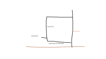

I am in the middle of a Bathroom Remodel, I am trying to relocate the Vanity to the wall that has the Toilet located. The Toilet has a 3" Copper Vent running through the wall and out the roof of the home.
My Question is is it possible to drain the Vanity into the Toilet vent before the toilet flange and then tie into the toilet vent stack above to vent the vanity? my only other option would be to tie into the 3" PVC after the toilet
Thank you in advance for any help.

A diagram or photo would be required to be sure, but from your description, it sounds like it should be possible.
Cheers, Wayne
41,394
4,992
I am not sure what you are describing, but my best guess says you insert a sanitary tee in the 3-inch copper at the right height, and feed the lav p-trap output into that santee. Toilet is properly vented by the wet vent from the lav.
There would be a limit on the length of the trap arm.

Here is a very Crude paint layout of what i am trying to accomplish.
Thank you for all of your input.

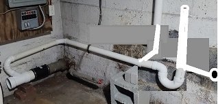

Here is one alternative:
index.php
Right side is from laundry sink(laundry tray). Note the 90 in the corner is supposed to be a long sweep.

Here is a better layout of what is going on:
I am moving the Vanity to the opposite wall from where the shower is to the wall that the toilet stack is located.
the stack in the basement currently comes in to the basement turns up and has one 3" x 1.5" PVC Sanitee that excepts the Sump pump and is short coupled to another 3" x 1.5" PVC Sanitee from the tub shower and existing vanity then it turns and has a short section of 3" PVC and then picks up the toilet and then goes up through the wall and out the roof. Where it turns and goes up the wall is 3" PVC that transitions to 3" Copper. I need to verify that the 3" goes into the attic but I have been avoiding the Attic due to the heat currently. My plan was to tie the new sink into the 3" horizontal section after the toilet but was concerned with not having enough slope as i need to cross the floor joists from where the 2" line from the sink enters the basement.
I will be pulling the toilet to remove the tile from the wall behind it and would like to tie into the vent stack from the toilet for the drain and then tie the vent from the sink into the 3" Vent about 4 feet above the floor.

So, drainage wise your drawing is fine, the concerns are on the venting side:
1) Was the lavatory previously horizontally wet venting the shower? If so, and you move the lavatory, you'll need to provide a dry vent for the shower. Or if the shower is close enough to the stack, you could rework the order of connections to the stack to vertically wet vent the shower, depending on:
2) The 3" stack you have labeled as a vent stack, is there any drainage coming down from an upper story? Your labeling makes it sounds like a one story house, in which case no, but it requires verification. As long as nothing is draining down, then your lav drain and vent connections are fine as depicted, and will wet vent the WC. [Although the previous WC venting was weird, as it looks like it was a horizontal dry vent below the floor.]
Cheers, Wayne

Wayne,
1) I will investigate the Venting of the shower when I remove the existing shower and vanity, My guess is that the shower is wet vented via the lavatory.
2) The 3" stack does not currently have any drainage before the toilet. It is in fact a single story ranch home. There was a horizontal Dry vent from the Toilet that turns and goes up through the wall
