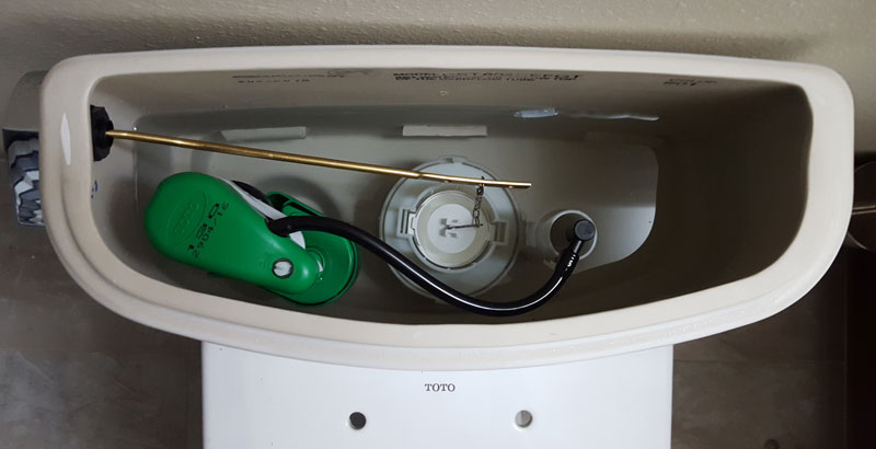

The new flush tower that you may see in the Drake II tanks.
This picture is from an Ultrmax II.

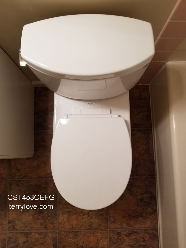

The Drake II now comes in round
CST453CEFG for the 1.28 and CST453CUFG for the 1.0 gallon
This one was installed on Whidbey Island.
As you can see to the left, there was a doorway there. The shorter bowl was nice for this location.

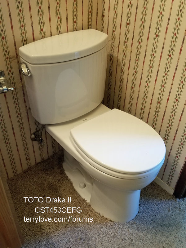

A round front installed in Carnation Washington.
I'm not a fan of carpet, and I believe there is tile happening in it's future.
I had previously installed two of the elongated versions upstairs where they had more room, and the homeowner was very happy with how they handled well water, so a third one was installed in the small bathroom.

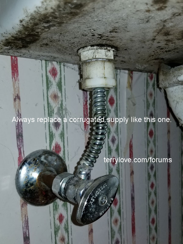

The old toilet had this horrible corrugated shutoff that was replaced with a new quarter turn valve.
