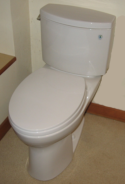

The CST454CEFG Drake II, rated at 800 grams has been working very well.
Watersense 1.28 Gallons
CEFIONTECT
Universal Height
Elongated

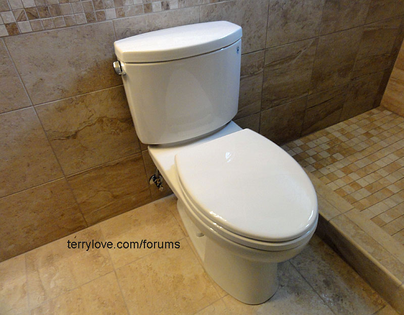

And TOTO now has the Vespin II, with skirted bowl.
The Drake II and the Vespin II use the same stylish tank, with the Vespin getting the Skirted bowl treatment.
That means the Vespin II can be used on a 10", 12" or 14" rough-in.
TOTO Vespin II, CST474CEFG
Universal Height
CEFIONTECT
Skirted bowl

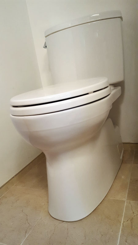

Toto Vespin II CST474CEFG with SS114 Softclose seat.
This bowl was installed on a 13-1/2" rough-in using the 14" Unifit adapter.
The water shutoff can be as close as 5-1/2" to the left of center, unless it's higher off the floor, and then it can be even closer to center.
This shutoff had been replaced with a new 1/4 turn valve with brass nipple through the wall.
Installation was by James Love of Love Plumbing & Remodel 206-949-5683
In some of the older Seattle homes, the old toilets had been wall mounted tank toilets.
Those typically are 14" rough-in and need a flange repair to use standard closet bolt connections at the flange.
Everything is on the truck for that.
The Vespin comes with a standard 12" adapter or you can order a 10" or 14" adapter depending on your rough-in distance.

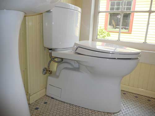

I just found this picture funny....
"Hi Neighbor!"
Interesting place for a window in that old bathroom.
