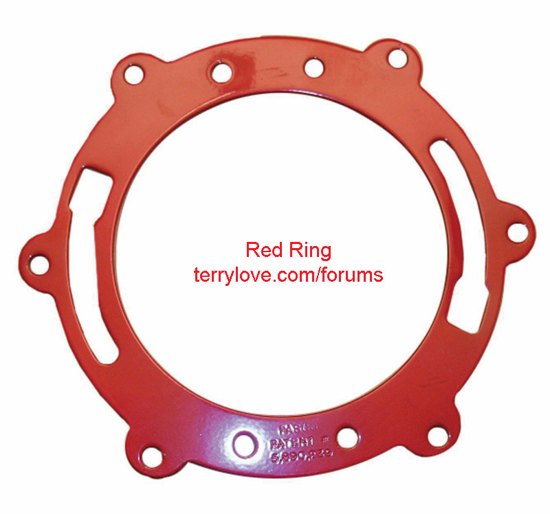

I have burned through 5 bits trying to drill into my bathroom floor in order to secure a new repair flange. The top layer is marble, which I’ve drilled through with a Tapcon carbide tipped concrete bit. Since then I have tried every type of bit: black oxide, cobalt, titanium, carbide, glass & ceramic tile - and finally - a $15 Milwaukee Diamond Max 10x Life bit for porcelain, tile & stone. Even the diamond bit was worn down to a nub as smooth as a baby’s ass in a couple of minutes. Yes, I followed directions, tutorials, drilled slowly, with steady pressure and kept the bit cool. No, I’m not an idiot. I’m guessing there is vintage Chicago hex pattern mosaic porcelain under the marble, but a diamond bit should still be able to do the job, right? What manner of adamantium devil craft am I dealing with here? I am on day 3 of this hellish nightmare. Now I know why the previous installer used such a half-assed, jury-rigged solution to mounting the toilet with no flange. Thoughts/suggestions/advice appreciated.

Are all of the holes over the hard-to-drill stuff? Are there holes in the ring part, rather than the ears, that are over something easier to drill?

As I noted, I got through the marble and I believe the next layer probably is porcelain. Thanks for the alternate hole suggestion. There are indeed 4 other holes on the ring itself, but unfortunately I ran into the same issue with them. This Suuuuuuucks!
