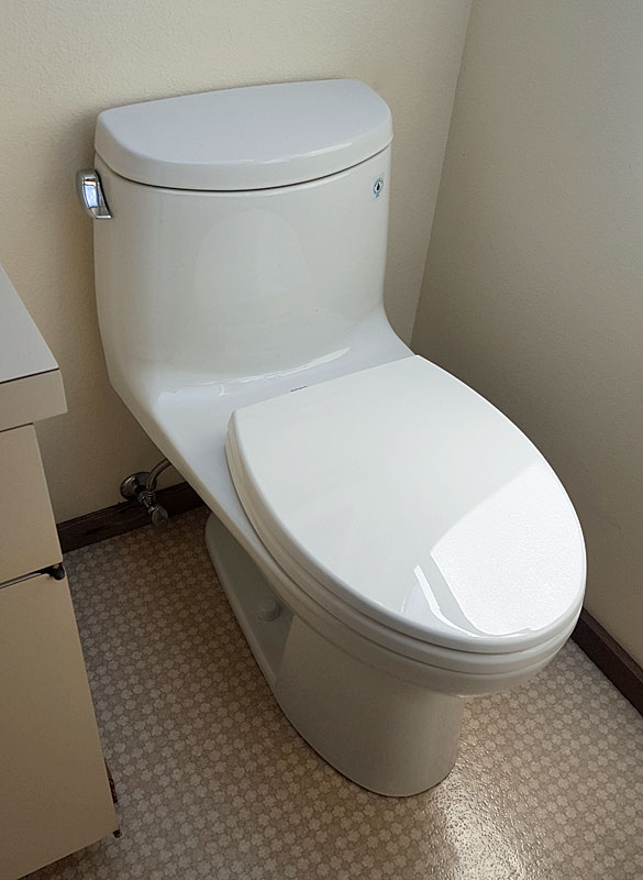

A fun Whidbey Island job. It's nice sometimes to get out of the city and take a long drive. I installed three toilets for them.
In the upstairs.

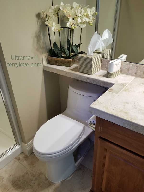

Hi, we are looking to replace 3 builder-grade toilets in our new-to-us home and are strongly leaning toward the Toto Ultramax II.
Two of the bathrooms have a banjo counter top. Height from floor to bottom is 31", which appears to offer enough clearance based on my research.
The depth of the banjo is 9". I haven't been able to determine if this depth will interfere with maintenance or the seat when upright. Any assistance would be appreciated.
