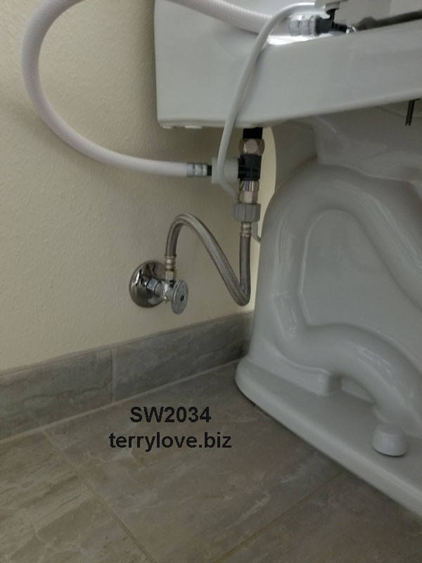

Without the "Connect" hole in the bowl, you're getting the standard hose and cable. I normally put a waste basket on that side, so I'm not really thinking of those anyway.
These are an easy install. I like to pick up a 20" supply line which gives me plenty of room to curve the line to make my attachment to the fill valve for the tee adapter. A 16" will also work.

I spoke with Toto support, they were great and they said I need C5 model SW3084 (Washlet) for my Ultramax II that doesn’t have a connect hole.

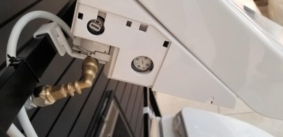

They even sent me this attached image to see what it would look like, personally I find it looks really bad in this picture, the hose sticks out so much, is there a cleaner way to do it? They had mentioned all the necessary equipment is included with the C5, if there is a cleaner way to do it can you specify how and maybe a reference photo if you can find it.

Here is a picture of my supply line, does that mean I will need to purchase this Tee, Toto support had mentioned everything I would need for the install would be included with the C5, is that not the case?

The C5 we have in our showroom has a 90° swivel elbow at the hose where it meets the washlet. Not that hose coming straight out the side.
