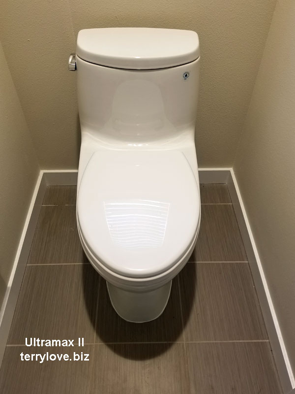

TOTO Ultramax II with a bowl height of 16-1/8" makes it a little easier to get up and down.
Comes standard in the whites with super smooth bowl finish to make cleaning easier.
MS604114CEFG
TOTO Ultramax II, MS604114CEFG toilet review
Made in USA
Video of performance
Toto has a new model called the Gwyneth with the WaterSense Ecoflush.
1.28 gallons, with the double cyclone rinse and CEFIONTECT in White, Beige/Biscuit and Bone. The Gray and Ebony/Black are without CEFIONTECT. It comes with the SS114 softclose seat and is the universal bowl height 16-1/8" before the seat is added. MaP testing has given it a 500 gram rating, which in many oppions is plenty for performance. Specs for Gwyneth

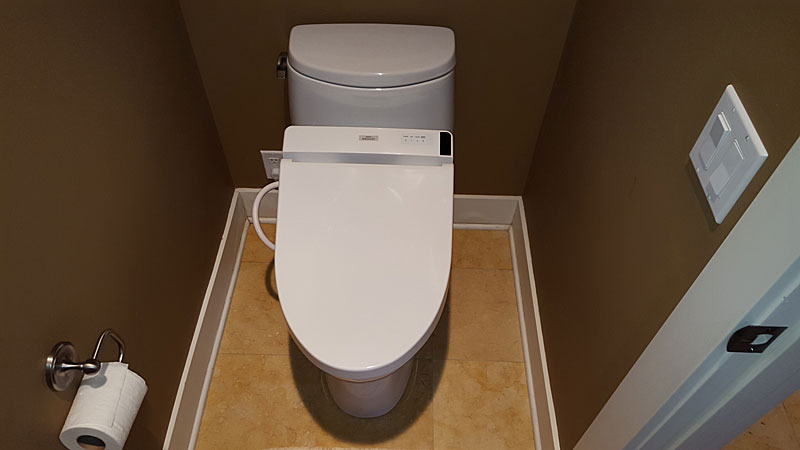

Ultramax II with C200 Washlet installed.
Out of the box, the Ultramax one-piece is a pop and drop installation.
Pop the box, and drop it on some new wax.

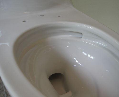

The bowl hase two rinse outlets near the top of the bowl, the water swings around the bowl when rinsing. Toto calls it their "Double Cyclone"
White, Beige and Bone come with the super smooth ion barrier glazing that they call CEFIONTECT. I have a bowl downstairs with the same glazing that is 2.5 years old, and it's still very smooth, like the day it was installed.

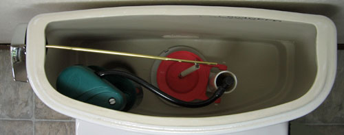

Inside the tank of the MS604 Ultramax II. It uses the Red Toto 3" flapper, replacements are found at most hardware stores. The fill valve prevents overfilling of the bowl.

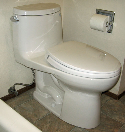

Have had our two Gwyneths since June (CEFIONTECT) and have had no clogs or problems. One does need to be sure to push the flush lever down completely (no need to hold there, though) as an incomplete push can result in an incomplete flush. Expect that's the same with all toilets.
I really like the look, too.
And if you have any concerns about the seat shape - one gets accustomed to it very quickly and I now prefer it to the flat seat on our 1 remaining waterhog toilet. Had some doubts prior to purchasing.

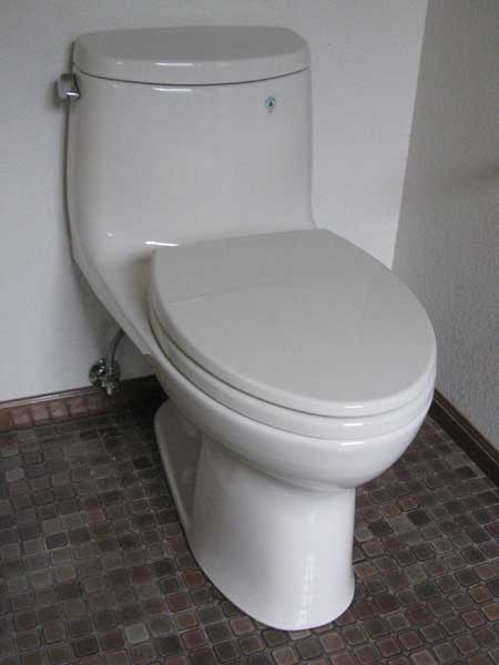

I've been using a Gwyneth one-piece for a few months now.
The water in the bowl is pretty similar to the Drake and Ultramax, except that there is a bit less volume in the bowl.
The flush is pretty quick and rinses fairly well.
The comfort height is nice.

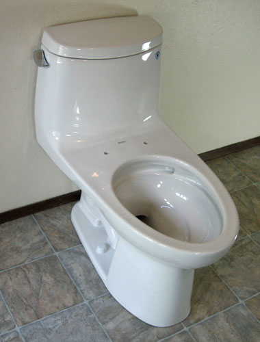

Gwyneth - Two Piece
I installed a two piece Gwyneth a week ago and it is working fine.
It was installed into a narrow space so I opted for the two piece to make it easier to set in place. (Bad Back!)
The first Gwyneth I purchased was not flat on the bottom and caused it to rock. I took it back and got a new one. This one was perfect. The install went well. The first flush caused a gush of water to shoot out of the bowl and hit the wall. That made me worry. But after that initial flush, it has worked fine. The flush is very fast and the tank fill time is probably about 30 seconds. Much faster than the old toilet.
The only problem I had was tightening the tank bolts. There are three tabs on the back of the bowl that are supposed to touch the tank when everything has been installed. I tightened the two tank bolts as far as I felt comfortable but there was still about a 1/16" gap on the left front tab. I am afraid to tighten it any further for fear of braking the tank. This is exactly why I would opt for a one piece toilet if I had room to maneuver around to install it.
I am very glad I purchased a Toto toilet. Much more expensive than the standard toilets but it shows in the quality of the toilet.
