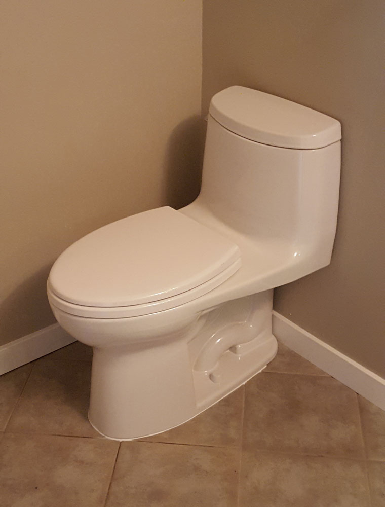

I am almost the owner of a Toto Ultramax II, 1.28 GPF toilet and wanted to share my experience so far.
My toilet was ordered from an online vendor on Sunday, April 30, 2017 to be shipped to me via a freight carrier.
On the evening of May 4, 2017, I was contacted by the trucking company that my toilet would be delivered between 3 and 7 pm on May 5, 2017. At 7:07, one of the guys on the truck called me and said they were running late and would be here in about 40 minutes. At 7:44 pm they pulled up and one of them got in the back and started moving freight around to get to my toilet. There were two toilets stacked on top of each other, mine was upside down on the top of the second toilet. When he pulled it off the stack it fell and the lid was broken and there was a large chip in the tank.
It’s obvious to me that the reviews I read about how well they are packed were wrong. There was absolutely no packing material around the tank and the lid was on the tank with no cushioning between the two and the box above the tank wasn’t even sealed. I could see that it was fully assembled but I couldn’t see the bowl to see how it was packed.
I am not at all happy about waiting four hours and forty-four minutes only to have the toilet damaged and never even make it off the truck.
I have no faith that a replacement can be shipped without damage if that’s all the better the units are packaged.

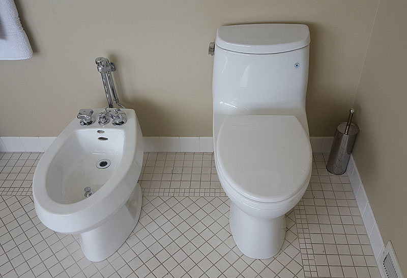

Aloha Terry. I have older Ultramaxs that I'm happy with. A friend has asked my opinion since they want to change out their older Kohler and Toto Washlet to an ADA Toto and S350e. I'm going to do the install. My questions are, I'm seeing a 1 gallon, a 1.28 gallon and a 1.6 gallon (mine). They now appear to have a tower or flapper (like mine). Saving water is not an issue. Is the tower better/desirable over the flapper? I was thinking the combo with the Washlet hole in toilet would be a good choice but I think that's only in the 1 and 1.28 gallon. Other than the Neorest (which they are also considering) what's best option for a one piece? Money is not really an issue. The side skirt side of other Toto models they don't care about since you can't really see the toilet from the side since it's in a stall. Main thing is flush, one piece and height since they both have bad knees. Will get it from a local Toto dealer. Also does one of the Neorests hit a sweet spot for bang for the bucks? Thanks.
3,482
The easy choice is the Ultramax II with 1.28. It works great and can be gotten with either the standard bowl or with the Connect bowl for the Connect Washlets.
The Connect does a little better at hiding cords and hoses.
Any of the Neorest are nice. I figure at least four hours for installing those. If you know the model at rough-in you can make sure the water supply is where you want it.

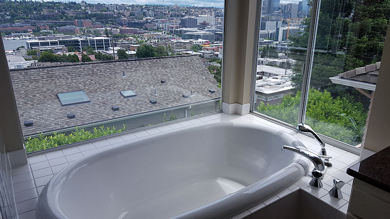

I installed an Ultramax in Seattle today and would have done a Lynnwood install but the rough was too short and the supply was from the floor and in a bad spot for TOTO. I switched up the brand on that one and found out that American Standard likes to hide the bolt caps inside the bowl where the tank mounts. They don't flush well with that bag of stuff in there. I had to pull the tank and pull the bag of goodies out.
Yes, I like the Ultramax II very much. And I prefer a Washlet or Neorest over the standalone bidets.
A nice view of Seattle overlooking Lake Union.
And they had a very nice dog to greet me.
