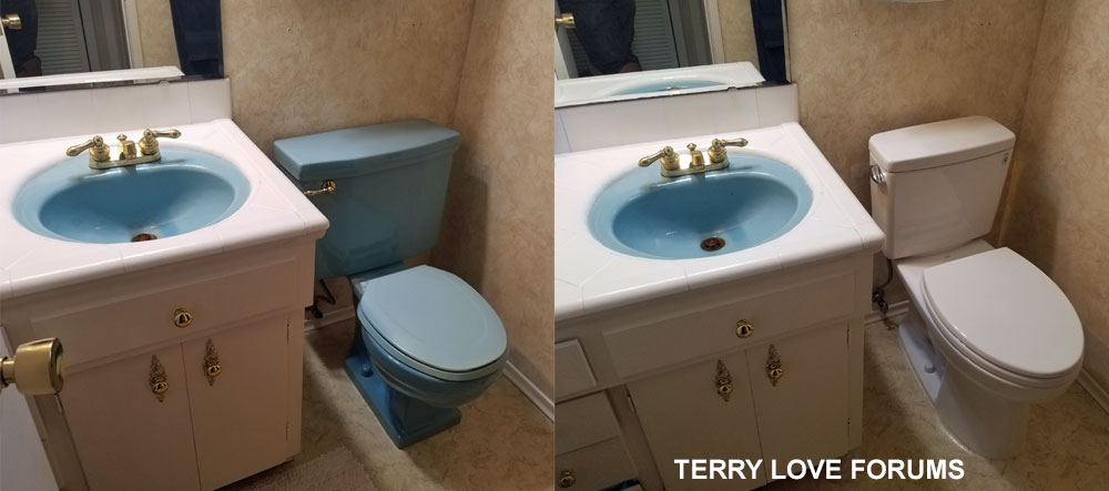

I bought two (2) of these new 2021 Drake toilets bundled with the s550e T40 Washlet+ bidet seat and auto flush accessory...
Couldn't be happier... Great bundle... Great product...
BEFORE
AFTER

Looks great! I really like the tank design of the Drakes both the 776 and the 786. Is that a surge protector? I might have to include those in the specifications for all our washlets and neorests
It's actually a smart plug... Allows me to monitor energy usage, and I can put it on an on/off schedule if need-be...
It's also great for on-demand remote power toggling... If I know I am going to be out all day, I can shut it down so the seat warmer isn't burning electricity heating the seat all day long... And then from my car, I can remotely turn it on so the seat is nice and warm when we pull up to the driveway... ;)
The energy usage allows me to look at the power usage signature and trending... This one is from my Sense Energy Monitor mobile app... As you can see, I started turning off the unit during the daytime when I was not at home the last two days...
