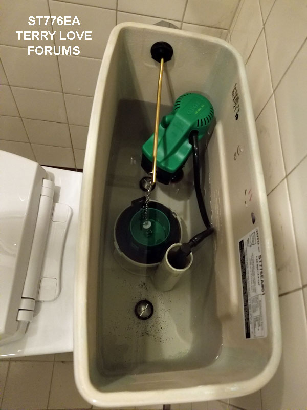

This one has breplum's favorite fill valve. Made by Korky.
CST776CEG
CST776CSG
CST776CEFG
CST776CSFG
CST776CEFG.10
CST776CSFG.10
C = TORNADO FLUSH® system
E = 1.28 GPF
S = 1.6 GPF
F = 16-1/8" bowl height
G = CEFIONTECT® ceramic glaze minimizes debris from sticking to ceramic surfaces

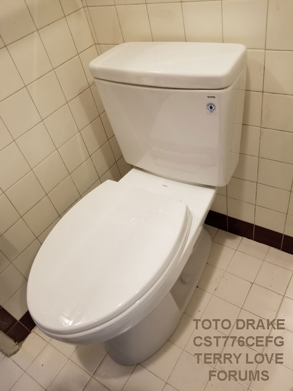

I installed this one today. I think they are going to be a big seller for me. They are like the Drake II but at a better price point.
