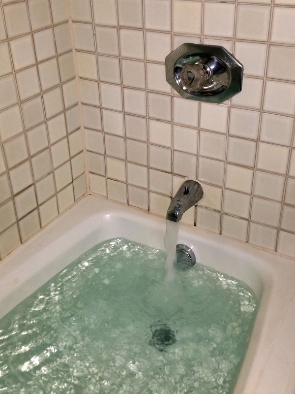

My daughter filled their tub up past the overflow tonight and I noticed water dripping in the basement; which I am finishing Fortunately the sheetrock isn't up yet so no damage.
The tub/shower is a standard fiberglass style. The drain/overflow assembly is a Watco 500 series made from tubular plastic and ties into the ABS trap with a slip joint. The overflow drain has two sets of screw holes, one for the cover plate and one for retainer plate. The plumbers didn't use the retainer plate and either just screwed the actual retainer screws in without the plate or just screwed a couple construction screws in those holes. Either way the overflow is leaking around the retainer screws.
What is the best way to fix this? I can order the retaining clip and the right screws and hope they don't leak. I can order a new 500 drain kit and replace the overflow ell. Or since having a slip joint buried above a drywall ceiling might not be a good idea even if I do leave an access panel, I could re-plumb it with all glue joints. The only problem with that is ABS is very hard to come by here now.

A picture will help.
Generally, there is a sponge gasket between the outside wall of the tub and the pipe fitting, and when you tighten the two screws, this gasket makes a water tight bond. You could have loose screws or worn out gasket.

DJ2, the overflow is not leaking at the gasket, the water is coming out of the screw hole for the retaining plate. I am attaching a pic and the water is coming out at the smaller gold construction looking screw with the arrow pointing at it.

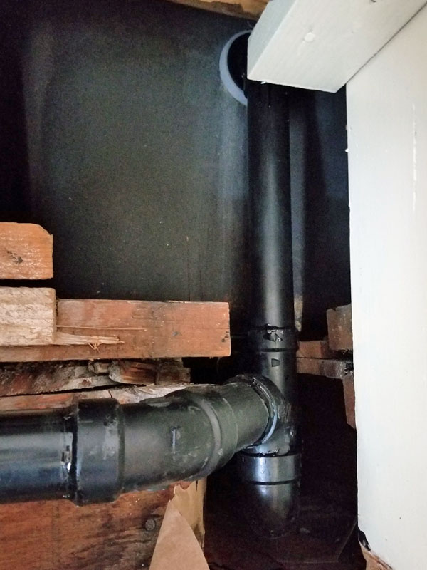

Thanks to everyone for all the replies and for this great site. I am going to start measuring to be sure all glued fittings will actually fit and line up with the existing drain line. Unless I want to use a Fernco I am locked into ABS as that is what the rest of the piping is is and my local AHJ said not to use the ABS to PVC glue.

So to be clear, first you attach the overflow ell and the drain ell to the tub, then you glue the pipes connecting the drain and overflow to the santee? Mine will be somewhat complicated in that the drain line connected to the trap comes through a hole in a TJI about 6" from the trap. So I wont have much room to flex the drain line to get the trap and the santee above all line up and glued. I wonder if I should glue up the ells and the santee, then unhook them from the tub to allow me some flexibility to glue the pipe from the trap to the santee?

You only need the depth of the fitting, 3/4" of an inch. Typically if the tub were in place, the short piece to the drain gets glued to the shoe, the long piece to the santee. Then that long piece with santee gets glued to the top, and then swings toward the drain. That's if the p-trap goes in last.
And yes there are several ways that can work. The main worry is making drain square with the tub.

Thanks to Terry and all the others that chimed in. Since the basement ceiling will be sheetrocked soon I decided to remove all the old slip joints and leaking overflow and replace it all with new glued fittings and a new drain. No one in town had a 2" abs trap and 1 1/2" reducer on hand so I kept the old trap. This made it a lot harder to get everything lined up but it is done and leak free. I texted my inspector about the change and he said given the work I had done on the rest of the basement he had already inspected, he didn't need to come out and see the new work.
