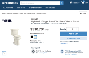

Needing a Kohler toilet, round, comfort height in biscuit. Ferguson offers this as a bundle, but would it work?? Never tried putting a Wellworth tank on a Highline bowl before.

Yep - the Wellworth Tanks go with the Highline bowls.
The only difference between the Wellworth and Highline models is the bowl. The tanks are the same.

I recently bought a set, no issues. stock number Mfr. Part #3947-96 for the round bowl. I bought the elongated set.

It will work. The wellworth tank will fit on the highline.
