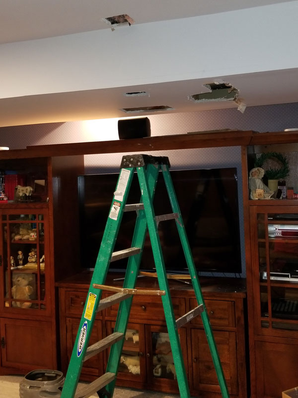

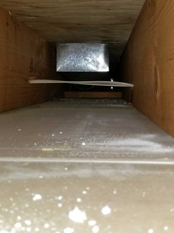

When I got there, a bucket was catching the water. Using the meter and measuring where the kitchen plumbing was likely to intersect I made my exploratory holes in the ceiling, finding the metal ducting and looking to locate where the pipes may be crossing over.

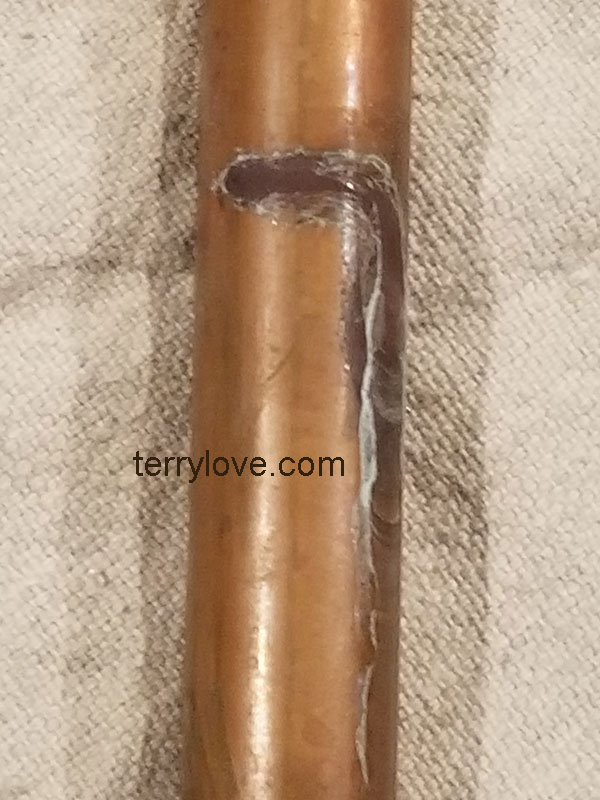

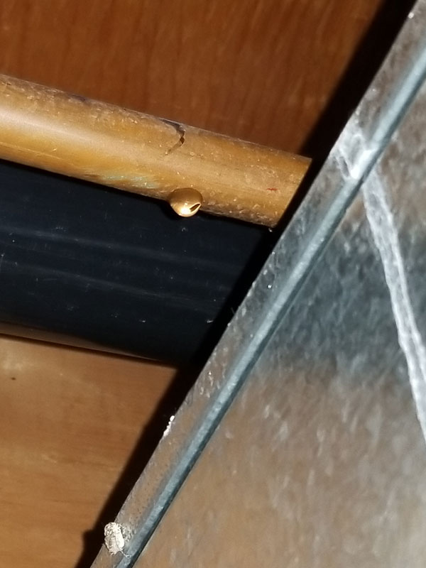

Bingo! I have a drip here and if I can open the other side, check for dampness I think we have it. I want to make sure that any leak over that ducting gets removed and replaced with new pipe. This pipe from the 60's has a weep coming from it. It's not on a joint, but oozing from the copper pipe.
Here you can see the water tracking from the pipe. I was lucky today. I've seen water travel a long ways but this time it was a bit easier to find.

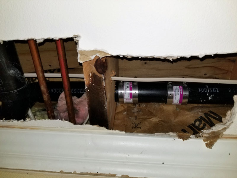

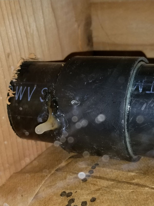

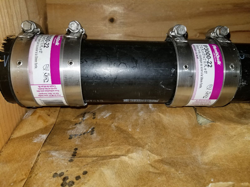

A leaking coupling on 2" ABS above the kitchen sink below the upstairs bathroom lavs.
The leak through the ceiling was noticed after Draino was used and showers taken.
The leaking coupling was replaced with a new section of pipe and two shielded couplings.
Before I opened up the ceiling I checked below the shower, located ten feet away to make sure it wasn't a drain leak on the pan, checking with a moisture meter. It was dry there, so in this case, the leak was right above and had not traveled.
There was some moisture heading out this way too, but not much. With the leak fixed, it will all be good.
