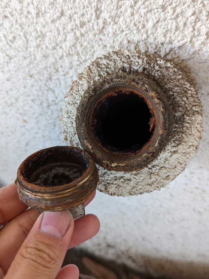

Hello everyone. i'm looking for some help / advice with a project i'm working on. My house is in southern California and was built in the 1950s with cast iron drain pipes.
I'll be installing a water softener and back flushing carbon filter on the patio in the near future. I am trying to determine best practice for getting the flush water from both the softener and filter into a drain. I'd rather not run it out into the garden. there is a cleanout located right next to where the softener / filter setup will go.
OD of the threads is 1 3/4. in a cursory search of the big box stores, this doesn't seem like a common cleanout cap size anymore. Is there a way to modify / adapt to get the appropriate arrangement (trap, standpipe, air gap fitting, access to cleanout etc) to use this as a drain for the water softener / filter? Is there another approach I should be taking here instead?

Here is a picture of the existing cleanout on the patio

Backflushing carbon filter drainage would be good for the garden, and softener drainage would not be good for the garden.
1-1/2 inch pipe thread is a little under 1.9 od, and 1-1/4 would be a little under 1.66.

that's a good point about the filter drainage versus the softener. hadn't thought about that.
i popped that cap out and cleaned it up a bit on the wire wheel. looks like the major thread diameter is right around 1.9. thanks for the clarification on the thread sizes.
