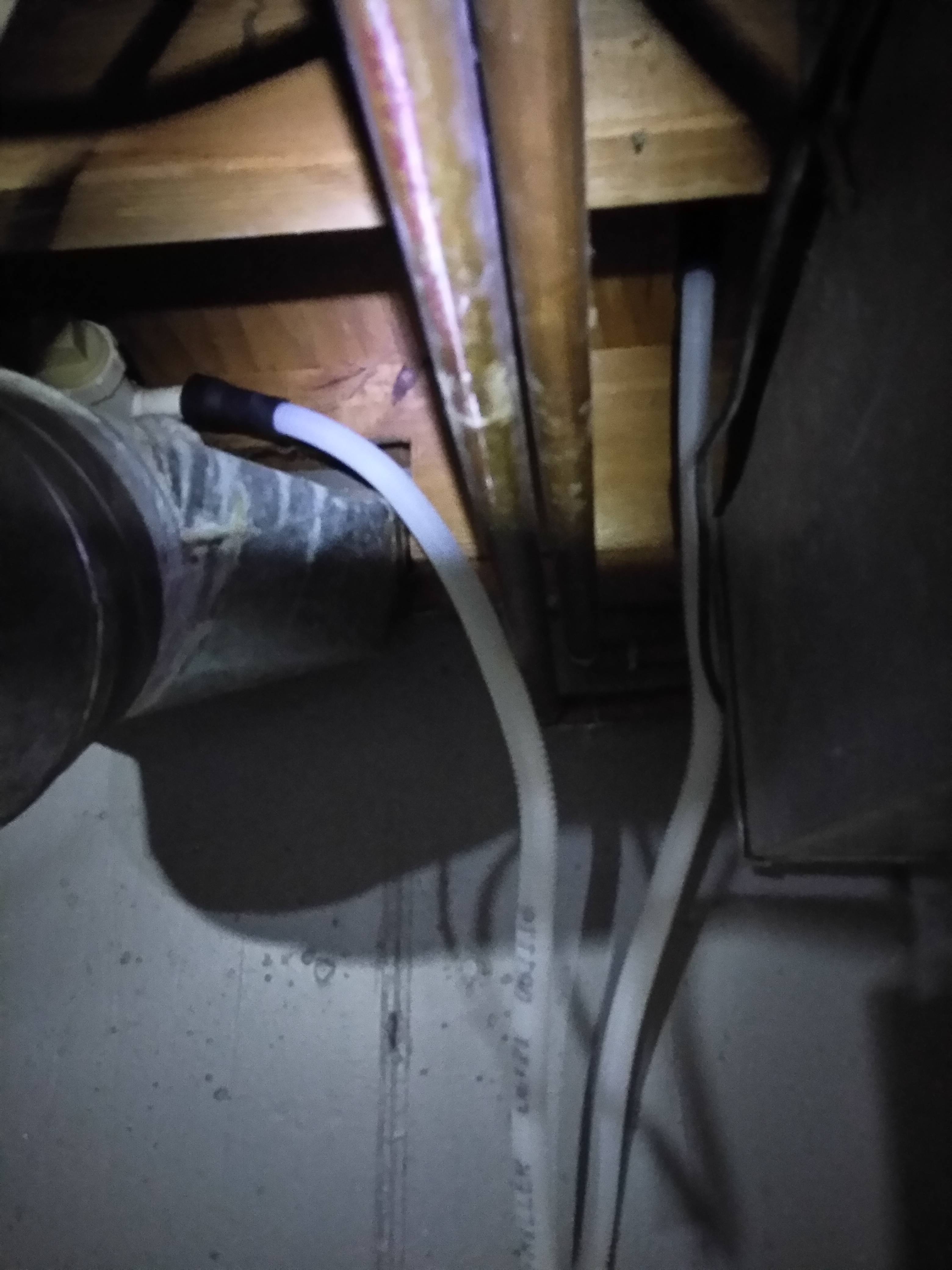

I haven't actually connected anything yet, as I'm not sure if its a good idea.

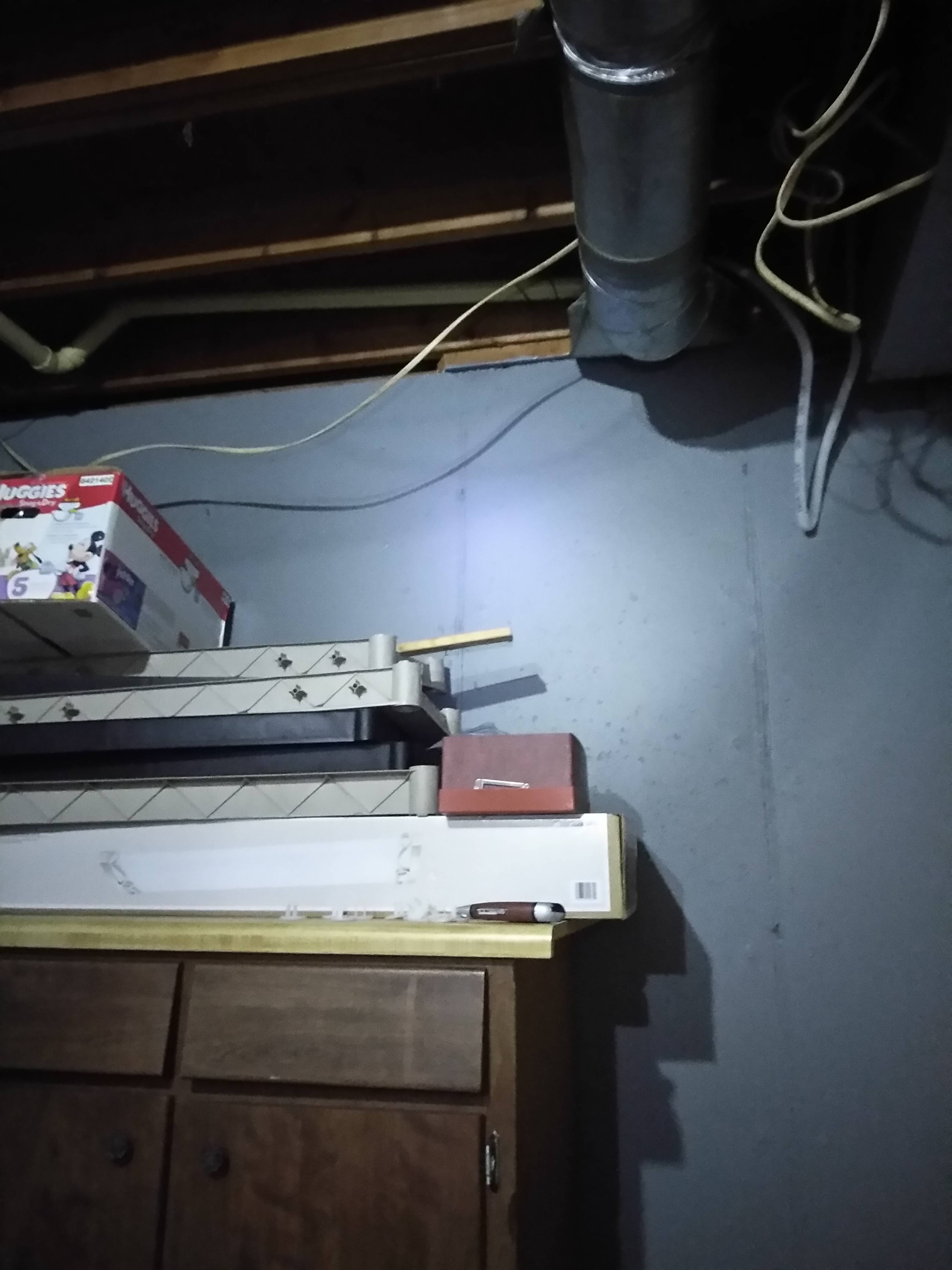

I am going off how the old dishwasher drain was installed. The drain starts with the loop on the side of the dishwasher, then through the hole in the floor, then has a large loop, after that the drain goes into a drain pipe.
The drain pipe has a slight incline then does a drop. This drain pipe then connects to a pipe that my sink drain also attaches.
Will this be okay to do?
Also, I know the wires hanging is dangerous. There is a lot to do on my house :/
Thanks in advance!

That is a bad idea because having the hose draining to a point below the unit can cause the hose to siphon, allowing the sewer gas to come back up into the dishwasher. The hose should come up to an air gap fitting placed in the countertop, and then drain to a properly trapped and vented drain.

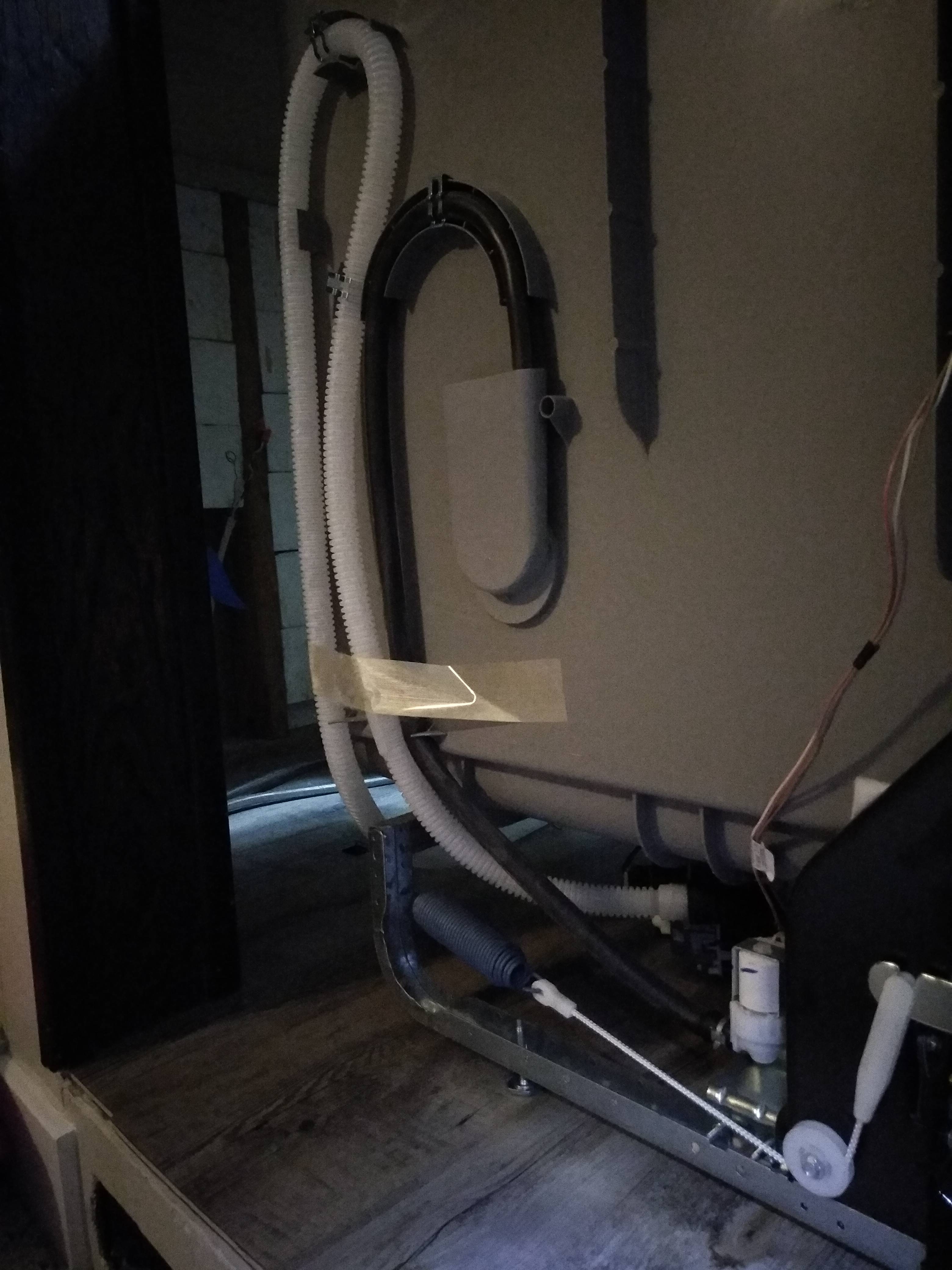

In the last few dishwasher calls I've been on, the dishwasher has an integral check valve which precludes the dirty water being sucked back into the dishwasher where the clean dishes are sitting pretty after the wash cycle.

I do have a new model with a check valve and I think it has a high loop(image 1 shows this I think). I should still put an air gap..I wonder if I can put the air gap just under the counter at the top of a high loop. That way I don't have this pipe cap sticking out on my counter.
