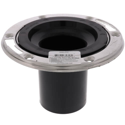

Maybe Sioux Chief has what you need: https://www.supplyhouse.com/Sioux-C...Hit5c6jFUAG73-kbIl-ZxlHSs2kvaC4hoC7IsQAvD_BwE

https://s3.amazonaws.com/s3.supplyhouse.com/product_files/SiouxChief-886-ATMS-Product-Overview.pdf only shows a 1.5 inch tail, but the picture seems to show that tail starting a little lower than the floor surface.
That Canplas 193617SS with green transition cement might be worth considering... or the inside long tail discussed above would be the other choice.

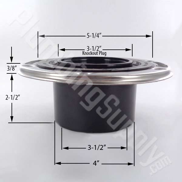

Looks like this may work:
https://www.supplyhouse.com/Nibco-I355500-4-x-3-SPG-x-SPG-ABS-Adjustable-Closet-Flange-58512A
If you look at Nibco's web site, their 2D sales drawing shows it as 2-3/4" overall height, 5/16" flange thickness. So the bottom of the spigot end would sit 2-7/16" below the finish floor. If the top of the hub is 1-3/8" below the finish floor, then gives you 1-1/16" of spigot engagement--less than the standard 1-1/2", but probably sufficient.

4x3 spigot x spigot -- what could that mean? It will fit into either a 4 inch hub or a 3 inch hub? I find that inconceivable.
Maybe it is a 4 inch spigot flange about 3 inch tall. If it were a 3 inch spigot that is 4 inch tall, that would be great for this application.

I think the spigot x spigot is just an entry typo. It's a 3" spigot flange, with the opening widening to 4" at the top.
I think I'd be more comfortable with 1" of ABS/ABS engagement than 1-1/2" of ABS/PVC engagement, but that's perhaps solely due to non-familiarity.

Actually it means it fits over a 3” pipe, or inside a 4” pipe. But My hub is inbetween those sizes since it takes 3” pipe. Since I cant find a longneck hub flange ive had to improvise. Im using a small pipe stub and a long neck spigot type flange that goes inside 3” pipe. The drawback seems to be that it narrows the opening to 2.5”. Some people have said it doesnt matter since toilets have 2.375” openings anyway, but Im not sure.
