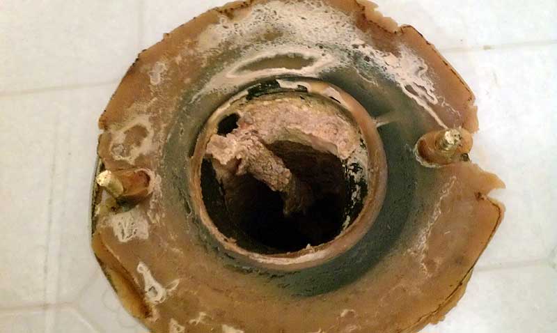

Terry has posted pictures previously of the bottom of copper drainage pipes from a toilet. One of the biggest causes is people that don't flush the toilet overnight after urinating to keep the noise down. The acid tends to flow down the pipe mostly undiluted, eventually eating the bottom of the pipe away. A typical toilet bowl is filled to the brim...when you add anything to it, some dribbles out so that the level stays the same. That tends to be more concentrated urine than must a mixed, diluted bit when you actually flush.

I pulled this out of a toilet drain. The homeowners didn't flush often enough, and it destroyed the copper pipe.
And here is a plastic drain filling up with salt crystals from urine.
