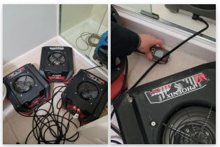

Hello everyone recently a friend over my house has taken a shower in the upstairs shower the last few days. Right below the shower this was found
The shower is right above this with water also dripping down a little at that vent.
infrared showed that entire ceiling had water all over it.
currently drying it.
at the upstairs shower area this area was the most wet
as you can see with a 99% rating under that tile.
also in the corner right near the shower door
dry wall chipping due to water.
question is from where?
now my friend told me the door was broken and didn’t close all the way. It closed about 80-90% which I verified and then he said he didn’t think it was a big deal so closed it as much as he could which was 90% basically and placed a towel down.
that towel was soaked by the way.
now the question is that what really caused this? Or was there some other overlying issue with the pipes etc causing this?
anyone have any ideas?
why is that area that99% not drying at all.
that bathroom is about 85-90 degrees and we’ve been drying for 3 days and nothing is drying there any ideas.

I can confirm the leak only seems to happen when water is running. So maybe it was from that door being open ajar?
Towel was for sure soaked with water so water was coming out of it.
I’m just concerned why that one area near the tile shower bed is not drying at all.
The room is 90 degrees with 3 fans and a dehumidifier running and it hasn’t dried at all,
