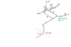

Back again with the continuation of my DWV puzzle.
Again, this is an apartment above a two car garage. It will be connected to the existing house by the time the project is completed.
The apartment (lav, wc, shower, washing machine, kitchen sink w/ disposal) drains via a 3" branch that goes vertically to its underslab connection to the fixture drains in the new construction that will connect the garage to the existing house. The "connection" is a laundry room, half bath and side entrance. Here are photos for explanation.
My question is whether the single 2" vent from the lav in the bathroom group meets the code requirements for venting the garage branch?

Your picture shows the shower unvented, shower trap arm needs to be horizontal instead of jumping straight up first
2"vent should be sufficient. If your in a cold weather climate you might want to jump up to 3" as you leave thy roof. Also if you can run a vent for the washer you should. A aav is probably legal in Georgia, but they sometimes cause issues, besides that who wants to have a maintenence item in their plumbing system?
His drawing is showing the shower tailpiece and trap at the far end, and the jog at the downstream end is horizontal, shown isometrically. The extra dashed blue lines on the verticals are an attempt to clarify that.
So the whole shower trap arm is shown as horizontal.
Cheers, Wayne
John Gayewski
4,363
1,348
Iowa
Cheers, Wayne
We've discussed this before. On piping iso's a vertical line is vertical pipe. There's no view where that isn't true. Being hand drawn its hard to tell, but they are drawn just as vertical as the riser. A 45° drawn horizontal would look funny and not be on the same planes as 90's. When someone draws a 45 they are shown with dotted extending through both planes that the 45 crosses.

Your underground shows a 4 inch line reduced to 3 inch that dosent have a proper cleanout (4 inch or 3 1/2 min . ). Also in that same picture from post 7 the upstairs drain line toilet , wash machine , sink shower and a lav are all draining down through a horizontal wet vent serving the w/c on ground floor . I dont think that meets code wherever you are?
It is horizontal, the explanation down thread is correct regarding my confusing iso drawing.
So, the venting for the garage portion appears to be code compliant?
I'm a 3A climate zone, so I don't think there's an issue with the vent freezing.
The washer would require an awkward chase to be built to vent it normally. IRC and Georgia don't prohibit AAVs, I'm pretty sure. I don't plan on using the washer/dryer hookups, I'm putting them in as an option for later down the road.
What is the requirement for the clean out, I'd like to read about it and understand it.
The photo of the underground portion is a done deal, that ship sailed on October 5th when it was covered with 27yds of concrete, LOL. Now that you bring it up and I've been deeper into the books, I understand it.
Yeah it's compliant, but I think Jeff caught something on the downstairs bathroom group. It can't be horizontally wet vented with the upstairs discharging onto it. You'd need a separate downstream branch for the upstairs to discharge into.
