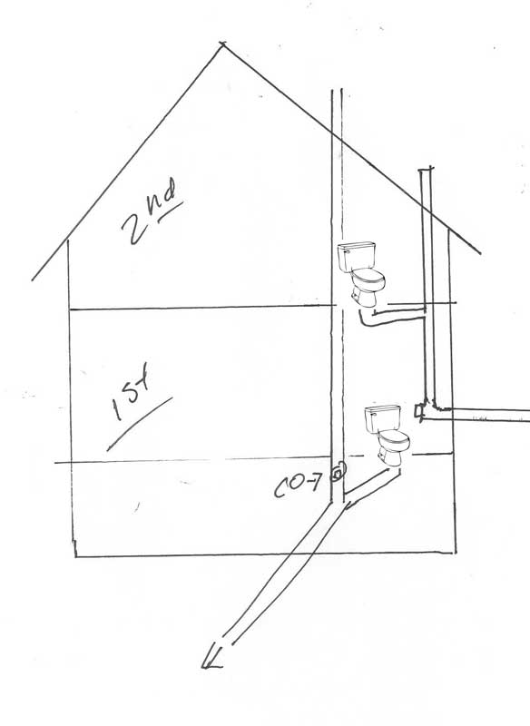

They let me know that I must be wrong. The downstairs is draining fine, so it must just be local to the toilet and tub. I ask them to check the downstairs again, because if it's a main line, and it's all the way to the second floor, it could be a disaster below. But no, like they knew already, the downstairs is fine.

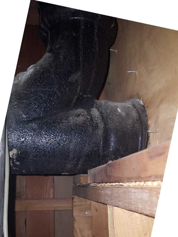

Anyway, so I mention to the homeowner that there must be two ways out for the plumbing. One for upstairs and one for down. It must be connected in two places. The homeowner let me know that though I was a plumber, even he could figure out that I was wrong. We started looking in the downstairs bathroom where they already knew about a cleanout near the floor. Yes, there's a cleanout near the floor, and about three feet above that one was a second cleanout.
Looking through the shutoff access door is the combo for the upstairs plumbing, with cleanout in the wall three feet high and going through the wall outside. Looking outside through the window we see the 4" sewer pipe above the ground going under the side walk. Yep, there's the upstairs plumbing, with it's own exit out the home.
Just so you know, this is not a common situation, but it can happen. One home, two or more exits on the plumbing. In this case, the upper plumbing, likely roots in the main line leading away from the home. Maybe a little Rootx in their future.
