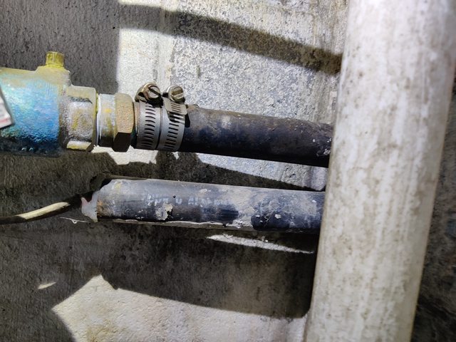

Poly pipe is going to be 1 inch SIDR pipe. That fits the barbs. It is usually considered better to stagger the gears on the worm gear clamps, but if there is no leak, I would leave those clamps as they are.

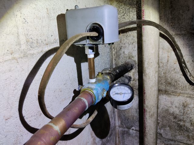

It is usually best to not have an above-ground check valve with a submersible pump. Is the nipple of the pressure switch screwed into a check valve, or is that just a manifold?
It is better to have the pressure switch closer to the input to the pressure tank. If the pump turns off prematurely, look to that as a cause. If no problem, no problem.

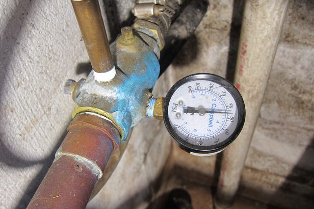

Firstly, I don't know whether the pump switch is screwed into a back-flow valve or a manifold but I will try to link a better photo. I don't recall seeing any arrows pointing to the direction of the water flow on that brass piece.
So, using your info, I will plan to cut back the SIDR pipe where it is threaded and install a 1" Pex B barbed adapter to run 1" Pex to a "T fitting" right near the entrance to the Pressure Tank (correction, Not Pump, sorry) onto which I'll screw in a Pressure Gauge, hose bib, Pressure relief valve, and lastly a ball valve shutoff.

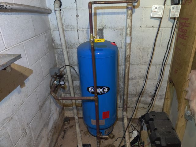

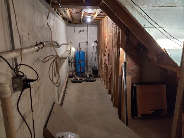

The pics show what the switch is screwed into, and a better view of where the current system is set up.
I'm thinking of possibly installing the pressure pump, and if needed the water softener (Not conditioner as previously stated, sorry), along the Left wall in the second pic.

Why? Do you mean the entrance to the pressure tank, rather than pressure pump? If you are not getting symptoms, I don't think I would make a change in that regard. Are you motivated to increase pipe ID? If no symptoms, I would leave things until you replace the pressure tank some day.
It would be very unusual to need a pressure pump if the well pump is a submersible pump. Usually, if you want more pressure, you turn up the pressure switch.
Regardless, I see no reason to cut back the SIDR pipe.

That fitting where the pump switch is piped never seen one like that. Not a back flow and doesn't look like a check. 3/4" pex has a smaller i.d. with valve and fiittings than copper.
