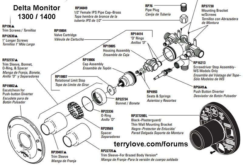

I have a Delta 13/14 Series faucet installed in 2011 and need to replace the cartridge but I'm unable to remove the handle cover. The only screw is under a cap on the end which I removed and loosened but the cover over the cartridge is stuck. I don't want to use too much force to remove it or scratching the finish. Any advice?
