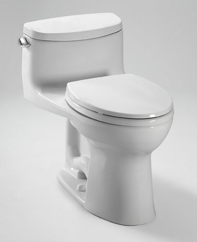

We need a low profile toilet and was recommended a Toto Supreme ii. I found a Supreme on for $150 less than the Supreme ii. What am I giving up? Is the ii worth the extra money?
Also, any other low profile toilets I should be looking at? 24" or so height is good.

There should be about a $82 difference between the I and the II
They both work fine. The II gives you the better bowl finish, the swirl in the rinse, and has a 1.5" higher bowl.
MS634114CEFG Supreme II

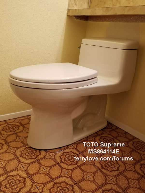

MS864114E TOTO Supreme
