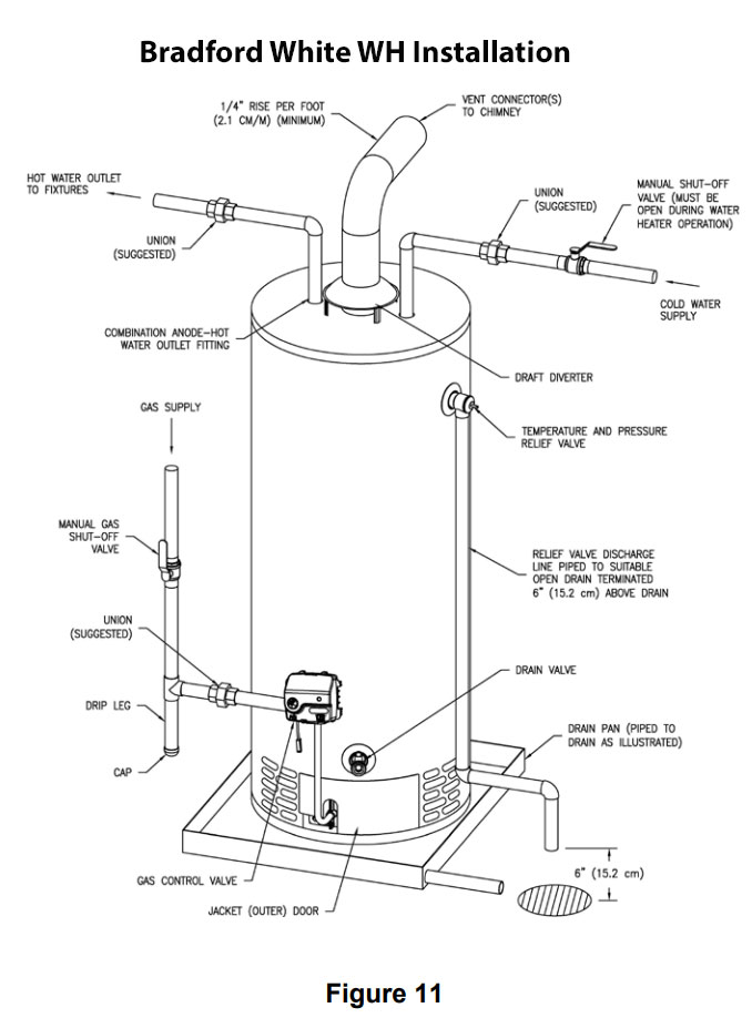

Hello,
today I was trying to drain and flush the 10year old water heater for maintenance. Here are the steps I followed after I checking out the instruction videos on YouTube: 1. Shut off gas valve, turn the knob to off. 2. Close the cold water valve on the heater water 3. Connect a garden hose to the drain 4. keep the hot water facet in kitchen open 5. open the drain valve 6. Open the T&P valve.
After 50 min of waiting, I briefly open the cold water supply to flush, water is coming out from both garden hose and T&P valve line (I am wondering why the water came out from the T&P valve line as well). I repeated it 3 times and the same thing happened.
I disconnect the garden hose from the drain, close the drain valve. Turn off the T&P valve, open the water supply to refill the tank. If I do not turn off the T&P valve, the water comes right out from the T&P valve drain once I open the water supply.
I have not yet relight the tank yet but I noticed water is dripping from both the drain valve and T&P valve. Water came out from the kitchen facet smoothly without giving any air splash.
The two valves on the water heater were not leaking or dripping before I did the maintenance. Now that they do not stop dripping and I am wondering if there were any steps that I did wrong through the maintenance and how can I fix it.
Please help and I really appreciate it! Thank you.

From your descriptions the tank never drained. Water coming out of the T&P and no air when opening a faucet. Sediment can easily plug up the drain valve and it never drained more than to the T&P level. Overtime corrosion and minerals can set up at the T&P valve. When opening it then closing it, the valve may not seat correctly and it might weep with a full tank. Sometimes just opening and closing a few times to flush it usually will work. A typical CA home with the WH outdoors, a hose it not needed. Just let it drain and you'll easily tell if it is draining or not. If it is really full of sediment, you'll need to remove the drain valve.

I totally agree with you. I just redo the the drain process and I realize that the water never got drained. I put a bucket directly under the drain valve and saw that the water coming out is slower than what I saw on YouTube videos. I think minerals build up at the drain valve.
The water has been draining for 1h. I am still letting it drain since the water comes out slower. I hope it will drain up completely shortly and I can proceed other steps. If not, I will just open and close a few times to flush like you suggested no matter it is drained out or not. Do you think it is a good step to go?

The tank does not have to be completely drained. The purpose is to flush out mineral deposits. It's OK to have drain it with the valve removed and then turn on the water to flush it out. Also, as Terry suggest, with a garden hose you can shoot water into the tank from the drain valve to help unclog it or with the valve removed, otherwise you did OK. Your drain valve was brass and that is good and it should have been fairly easy to clean it of debris. A ball valve is far easier to use but if kids are usually around, cap off the ball valve with a cap.

Hi my friends, I just want to give a update for what I have done to solve the problem.
As the two gentlemen above pointed out, I never drained the water completely at the first time. The second time when I was trying to drain I noticed that the water came out very slowly. I could not use the method of connecting the hose and flash water back to the tank to unclog since it has been several years of no maintenance. I chose to replace the valve with a ¾ ball valve. I was able to get water out and proceed with flushing and relighting. Everything works well now and I feel so relieved and excited at the same time that I learned something new :)
