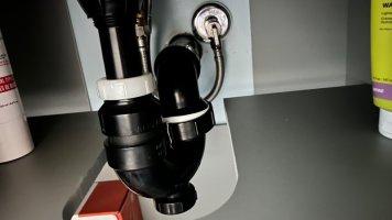

I have a bathroom sink drain that smells of gases. Bathroom was renovated around 3+ months ago and converted from a single to double sink vanity. When sinks aren't used over night I can smell gasses in the room the next day, I have traced the source to 1 of the two sinks. (one on right of pic) I also note the smell while using the same sink until a few min of running water clears up the odor. Both sinks drain fine with no issues and P traps are full of water in the morning. Pipe and venting is all 1 1/2 ABS, new venting cross the top to new sink is 30" above sink height. I tried enzyme cleaners along with short snake with no results or notable buildup. Also note original sink drain was moved 90 degrees to new wall to accommodate the double vanity.
We had a strong wind storm a few weeks back that may fit the time line of when the smell started to occur.
I am at loss and don't want to cut open walls with no game plan, any help or suggestions would be greatly appreciated.
Thanks

Can you takes pictures of the traps for each sink? Strong winds going over the roof vents can cause a low pressure area and suck water out of the trap. When you get the smell, remove the trap for that sink and try to determine how much water is in the trap. You did mention the trap is full of water, how did you determine it? Your picture "to stack" it's assumed to the roof vent?
Another thing you can do is leave each sink full of water and block off the sink overflow. It's to determine if it is actually the sinks. It a really easy thing to do and prove the source of the odor.

I did drop and empty the trap into container in morning when odor was occurring, it was full to top of stub out I captured all water while removing then marked and compared to filling the trap not connected to the wall, this yielded slightly more water when connected to stub out.
Yes to stack vents out roof
I did try plugging the 1 sinks drain with out water or overflow plugged over night and it seamed to stop the smell the few times I tried it. ( was expecting to get odor from overflow) I also found odd that in morning when I popped the drain there would be no odor until I run water. I will try both with water and report back.

I would expect the trap to be full to the level of the bottom of the trap adapter and trap arm, not the top. There would be a difference of 1.5 or 1.25 difference between top and bottom.
Full above the level of the bottom of the trap weir would indicate a clogged drain.

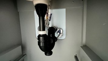

Here is some pics not sure if they will help no the greatest angles

no clog drains fine only small difference of more water when connected to wall assume this is normal? water would level to bottom of wall stub vs bottom of threaded connector if open.

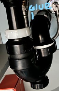

I would remove the PTFE tape on the trap. PTFE (Teflon) tape is for tapered threads. Maybe use a little silicone grease on the threads.
What connects the black plastic of the trap to the pipe from the wall. Is that a glued connection? Glued connections can keep things from being adjustable. Who made that connection?

I made this connection. Glued too wall stub, ABS pipe as per pic trap. I have only ever seen compression threaded style in PVC not used here in Toronto to my knowledge but could be mistaken.
Without the Teflon tape I would get a small teaspoon drip on shelf over night with that trap. Sealant or lubricant this solved it without having to cut replace trap.

Edit: Sorry. I had lost track of your symptom. I don't see how your current p-trap installation could cause a sewer gas smell. Your joint with the PTFE tape would be under water, so that could not leak gas without leaking water.
I would close the drain, put a couple tablespoons to 1/4 cup of liquid chlorine bleach into the bowl, and raise the water level so that water goes out overflow holes, then back the faucet flow to a slight dribble so the bleach solution goes out the overflow slowly.
