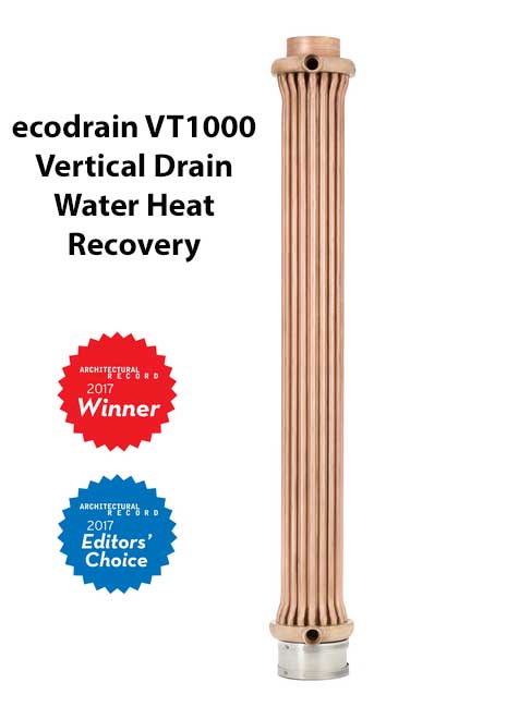

With multiple teenagers taking showers the "apparent capacity" of any tank water heater (including heat pump water heaters) can be extended substantially using a drainwater heat exchanger to pre-heat the incoming water headed to both the cold side of the shower and the cold intake to the water heater. They're not cheap, but cheaper than the upcharge between a 50 gallon heat pump water heater and an 80 gallon version, and a 4" x 48" or bigger can cut the total energy use by about half or more. There are others.
Energy use alone won't pay for the heat exchanger if it's a heat pump water heater (it pays for itself up front by the reduced size), but it will pay off on energy use well before you're rid of your brat-pack if heating with propane or a plain old electric tank.
The current best-in-class (on both return efficiency and lower pressure drop) is the EcoDrain VT-1000 series, which can be purchased direct from the manufacturer. (I don't believe this Canadian vendor has distributors in the US yet). Renewability's Power Pipe series isn't bad either, and can be gotten through the big orange box store's website and a few other vendors, or direct from the manufacturer , also in Canada. (I installed an R4-48 4" x 48" PowerPipe installed at my house over a decade ago and it's still performing well, but were I doing it today I'd probably go with a VT-1000-4-54.) They are sometimes discounted direct from Renewabilty on the Am**** site, but lately they've been close to full-retail.
Being on a deep well is usually an argument against going tankless due to rapid liming of the heat exchangers. Some manufacturers will even void the warranty if the well water tests over some water hardness level. (If you have a water softening system that can be better controlled.) They can work even with hard water, but plumb in ports for annual de-liming if going that route. I've seen them go 10+ years without maintenance on well controlled municipal water systems, but at the other end of the scale some homes will need de-liming every six months.
That would be really effective for long and consecutive showers.
A heat pump water heater could spend a lot of time using more-expensive resistance heating with long and consecutive showers. Setting that WH to heat-pump-only could limit shower duration, which could be good, but would also call for spacing out the showers.

Setting it to heat pump only when there are going to be 3+ consecutive showers would be the worst. Once depleted the recovery time is glacial- the kid has to be late for school or go to school smelly. It's better to have sufficient CAPACITY to serve up 4 showers of reasonable duration, especially if operating in heat-pump-only mode.
With a sufficiently large drainwater heat recovery unit, the rate at which hot water is drawn is reduced by 15-25% (even more for a really tall one), and the fact that the incoming water is already tepid means the recovery time to reach showering temp is cut in half. The tallest and fattest heat exchanger that reasonably fits is always the "right" one. If the water in the well is 55F and the temp at the showerhead is 105F, the water coming out of a 50% rated heat exchanger during showers would be about 75F at 2.5 gpm and warmer still at a 1.75-2 gpm flow. So even the water at the bottom of the tank when the output of the tank dips to 100F will already be half way there, and the average temp of the tank will be even closer to the 105F temp, assuming he heat pump started running as soon as the tank temp dropped below 125-130F (typical for a 140F storage temp setting on the water heater.)
