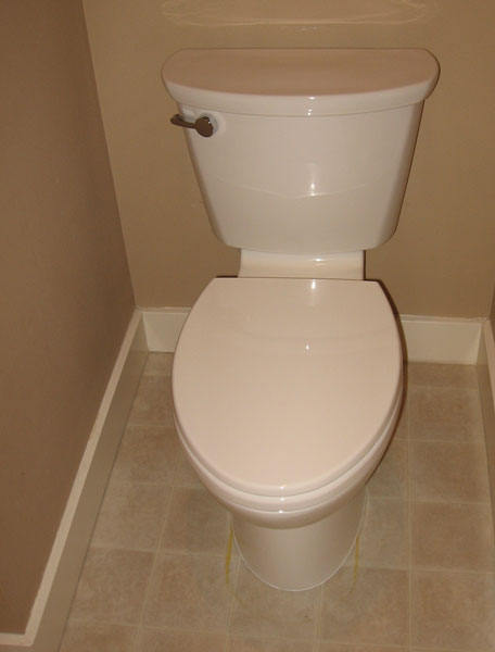

The Cadet Pro is a good toilet. Here is an elongated one with the 10" tank.
Thank you. Will probably just go with it then…. will have to bide my time for Toto in a different/bigger bathroom!. Many thanks!
