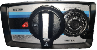

Thanks very much. I'm not at his house and he's away right now, so I can't answer your questions above. But I have attached a picture of the head. He believes the cycle had just begun when the power went out and he unplugged it.

That control valve is a Fleck 5600 Mechanical.
That type of controller is not the most efficient since regeneration frequency is programmed by the activation of toggle switches on the control dial on the right. Unlike a demand initiated controller that will initiate each regeneration whenever the specific amount of capacity that is programmed has been consumed, that toggle initiated controller will only regenerate on the specific day(s) of the 12-days where the toggle switch(s) is activated, regardless of the amount of capacity that was consumed since the previous regeneration cycle.
Your photo is too dark so I can't see what regeneration mode is indicated in the left dial's window.
Attached is a photo showing my Fleck 5600 mechanical with demand (meter) initiated regeneration. My photo shows the mode window displaying 'In Service' which is the normal mode for the softener to supply softened water to the home.
Constant chlorine exposure over an extended period, will negatively impact the lifespan of any softening resin, which is why I asked the age of the softener, and whether the water supply is municipal or private well.
Chlorine damaged resin will typically be identified by a high amount of flow reduction through the softener, which most people refer to as a loss of pressure, particularly while attempting to run multiple fixtures at the same time. The flow rate will be immediately restored to normal by bypassing the softener.
