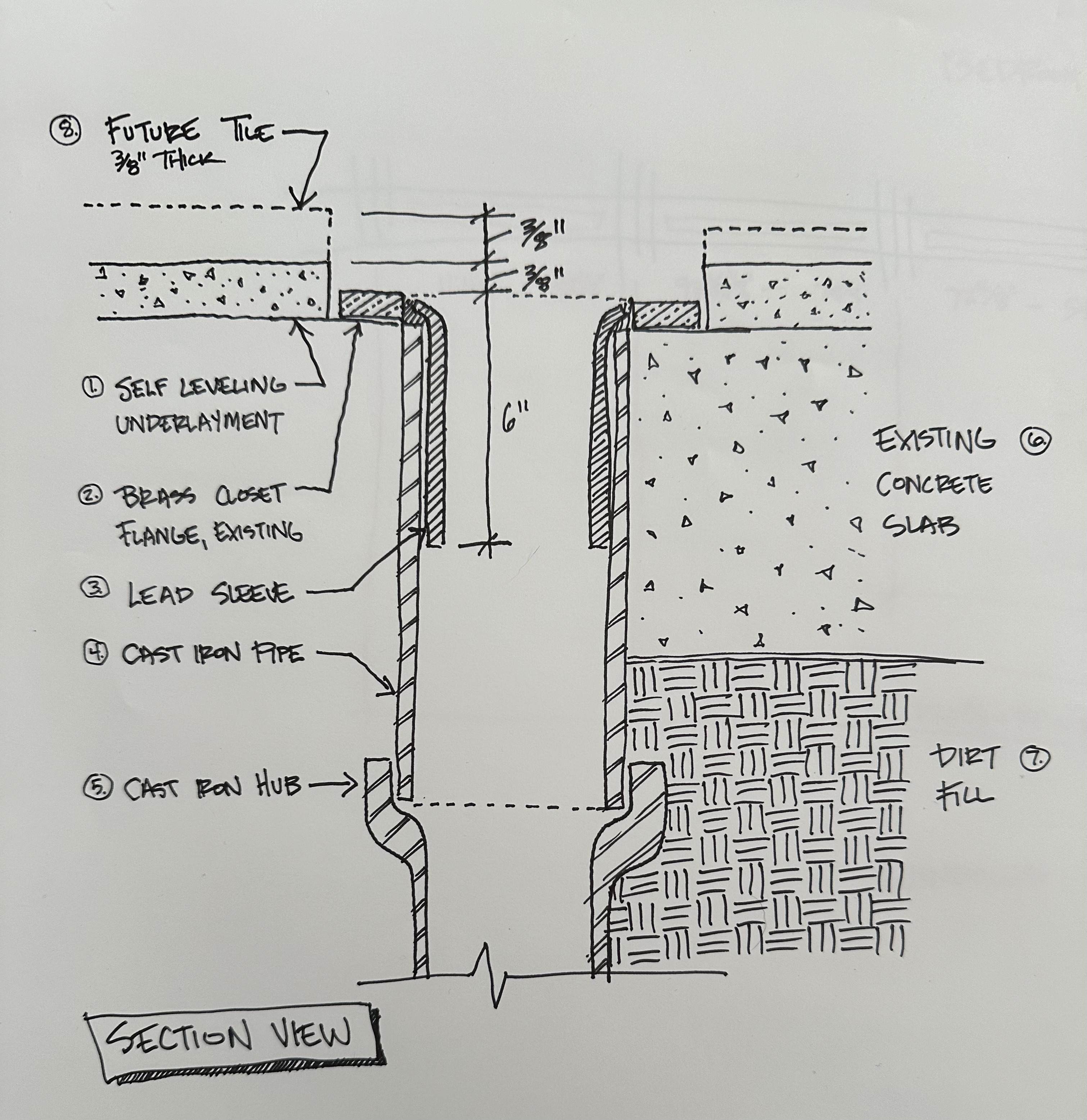

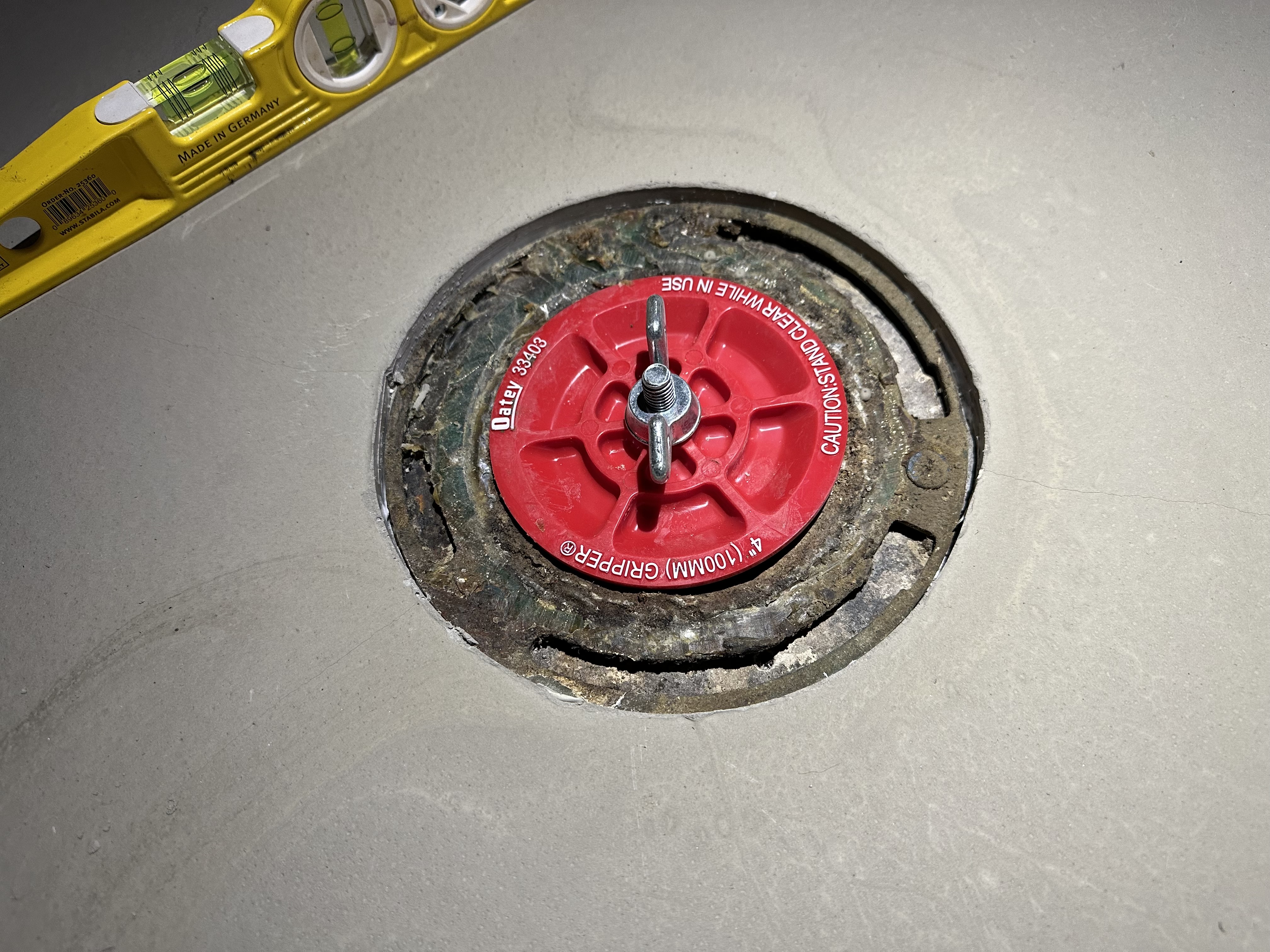

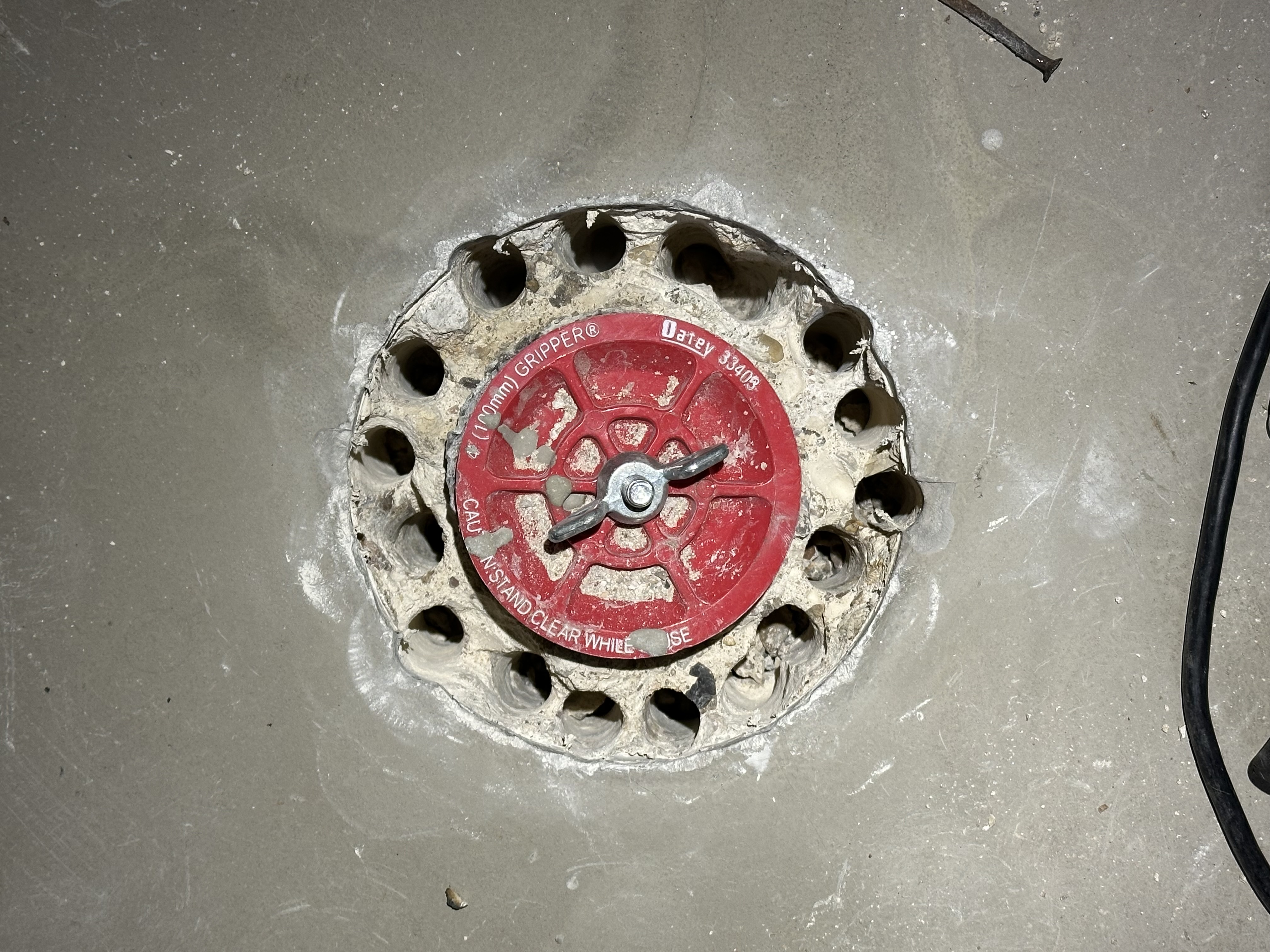

Hey y'all, I am looking for some advice on how best to raise a recessed closet flange.
I releveled the bathroom floors, and need to raise the existing brass closet flange up 3/4" of an inch. Raising it 3/4" of an inch will put the new closet flange on top of the new flooring. The existing brass closet flange looks to have been soldered to a lead sleeve that passes down into a 4" dia. cast iron soil pipe. This vertical stub of cast iron pipe connects into a cast iron hub.
Attached are a few photos of what I'm working with, along with a sketch of what I think the assembly looks like.

I might use the twist and set ring and place a 1/2 inch shim between the 2 rings and screw to concrete

Remove the concrete and either redo the cast iron, or convert it to pvc. You could possibly heat up and raise the flange also, but that might still require breaking up the concrete around the fittings.

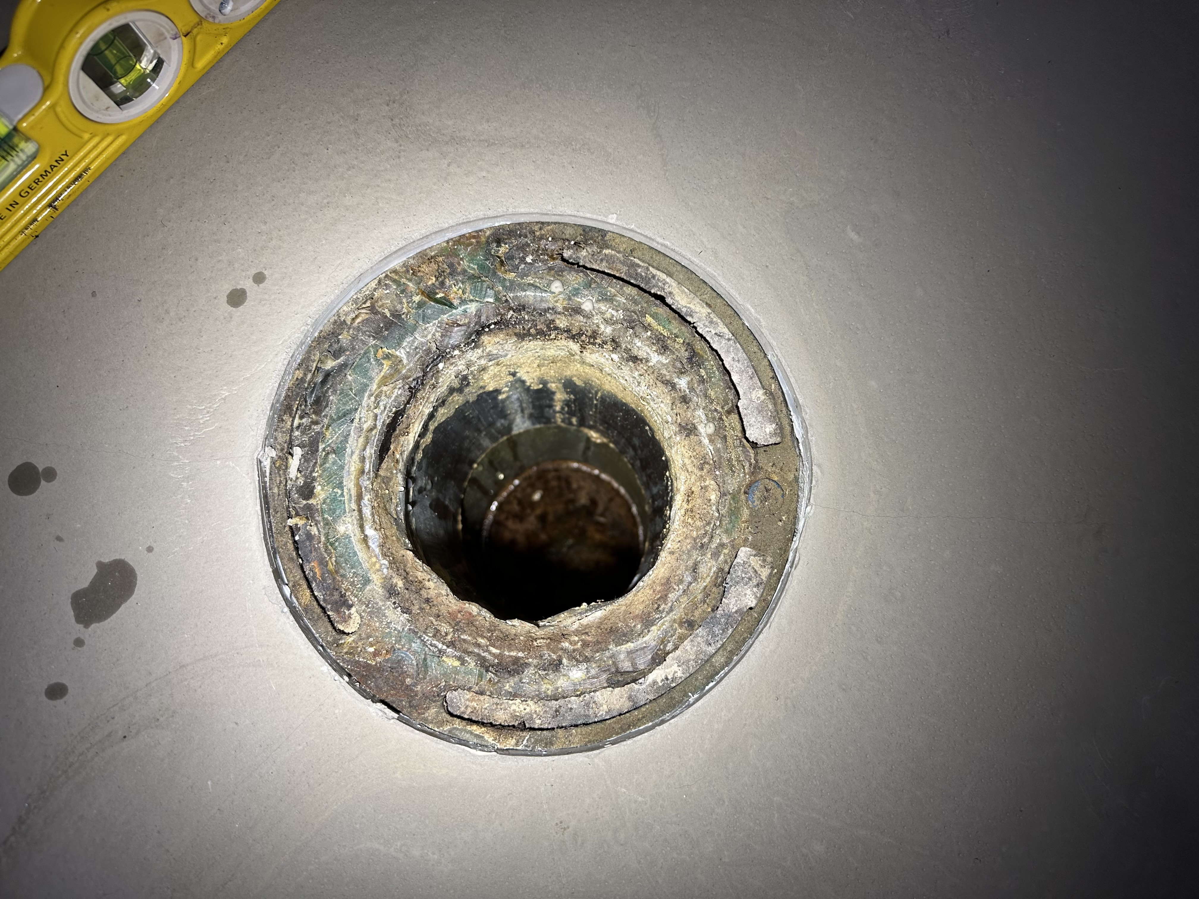

I think I will hold off on busting the concrete up and see if I can work with the existing brass flange. It looks like the brass flange is secured with a few concrete screws.
Here's the plan
1. Remove the screws.
2. Carefully raise the existing brass flange + soldered lead sleeve assembly. (Not sure if this will be successful)
3. Place an appropriate thickness spacer underneath the existing brass flange and lead sleeve, so that the flange sets proud of future tile floor.
4. Secure flange + spacer into concrete with tapcons.
Paul E.
46
Texas

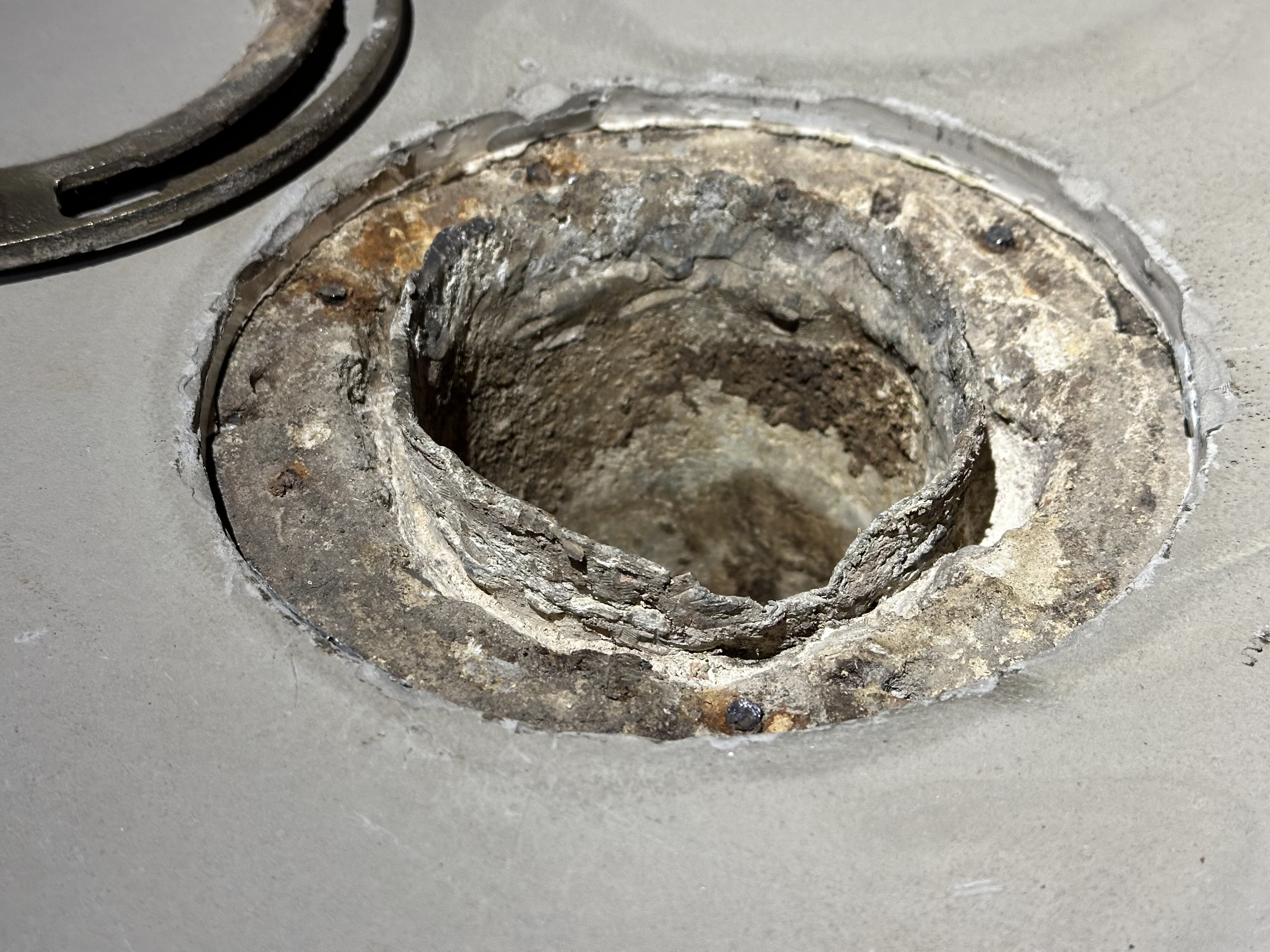

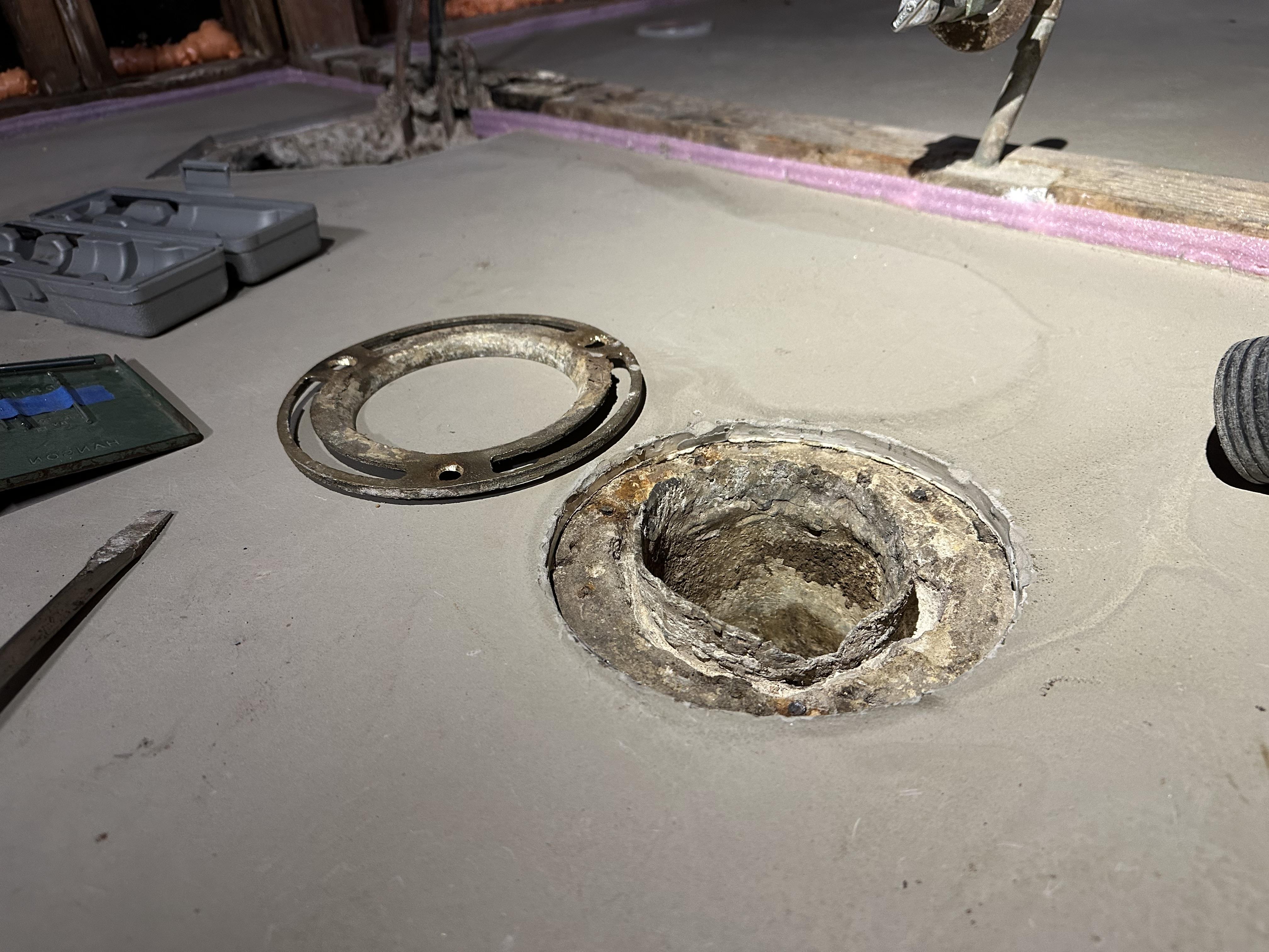

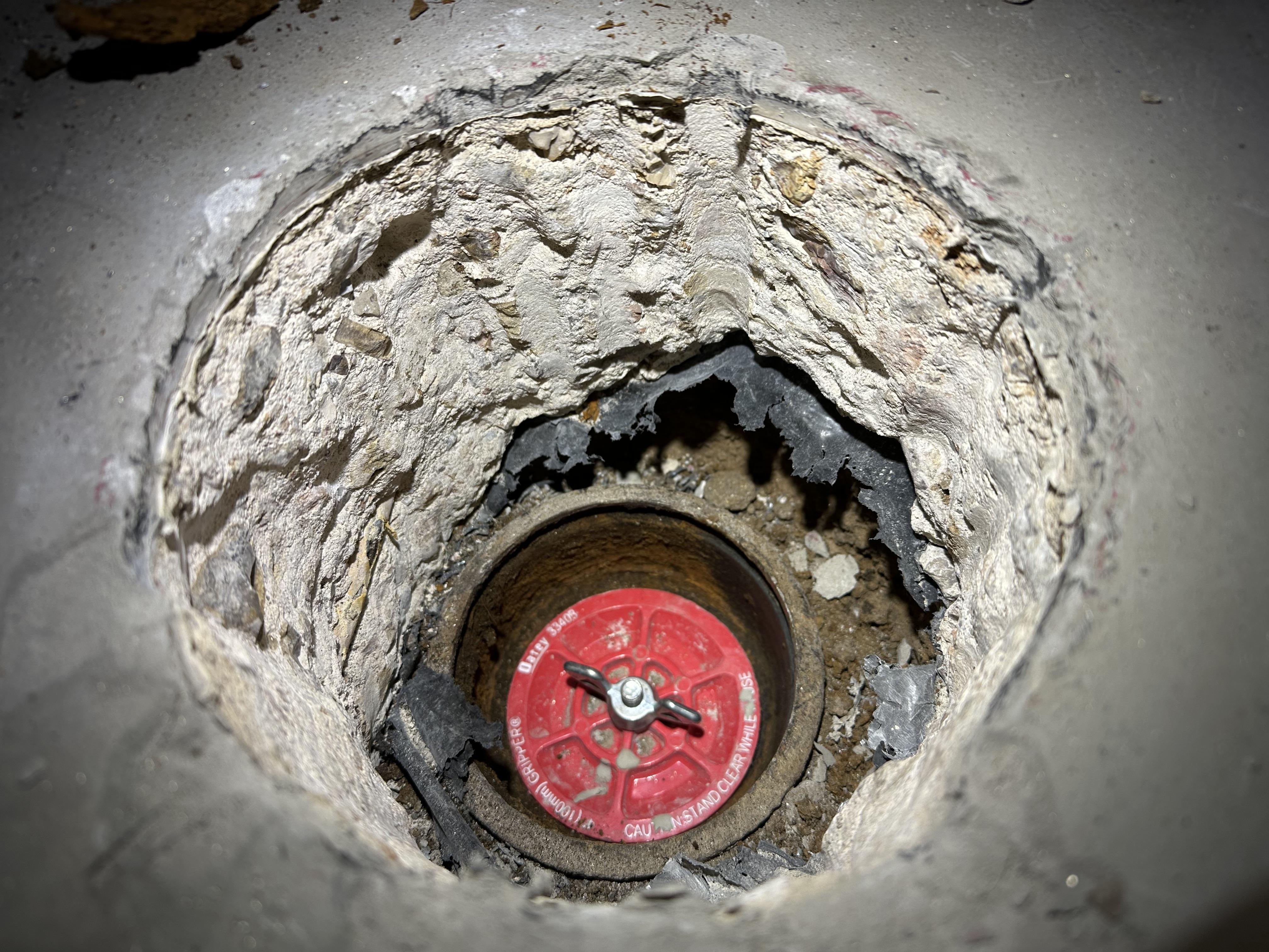

Turns out the lead pipe was not soldered to the brass closet flange, it was peened overtop it. The lead is fairly brittle. Can a new lead pipe/sleeve be purchased? I don't think I can pull this one up to my desired flange height without destroying it.

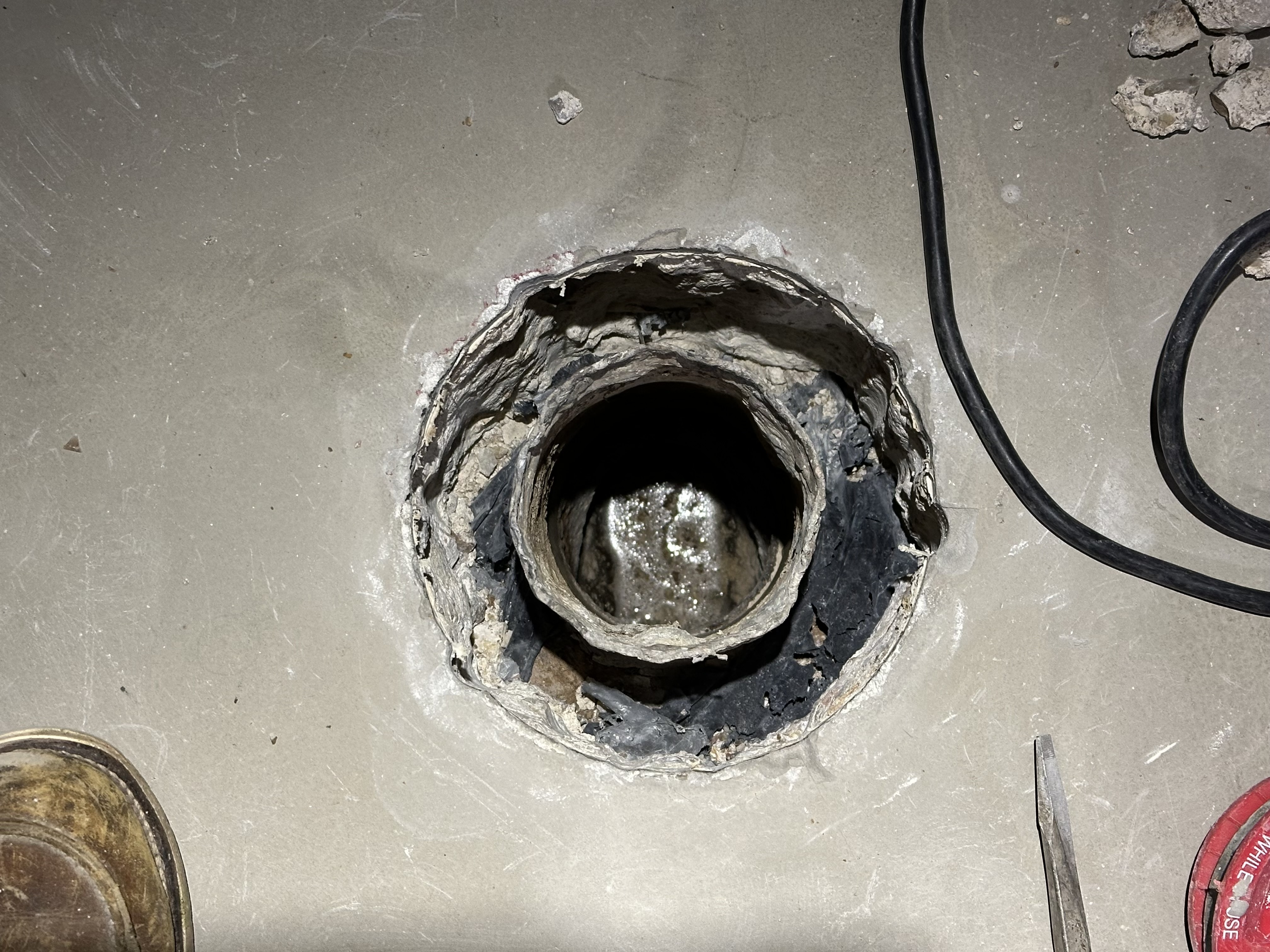

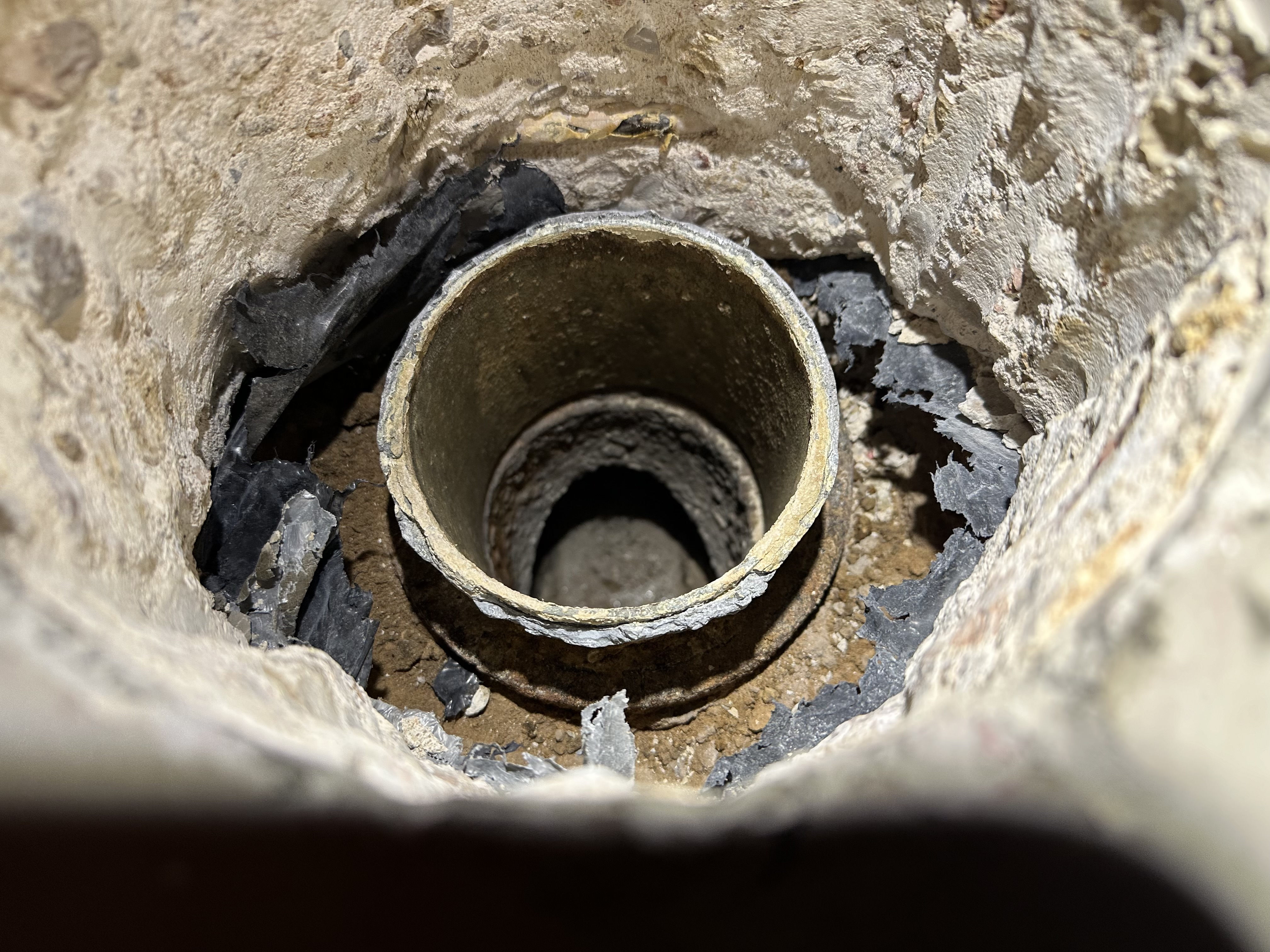

Decided to convert to PVC.

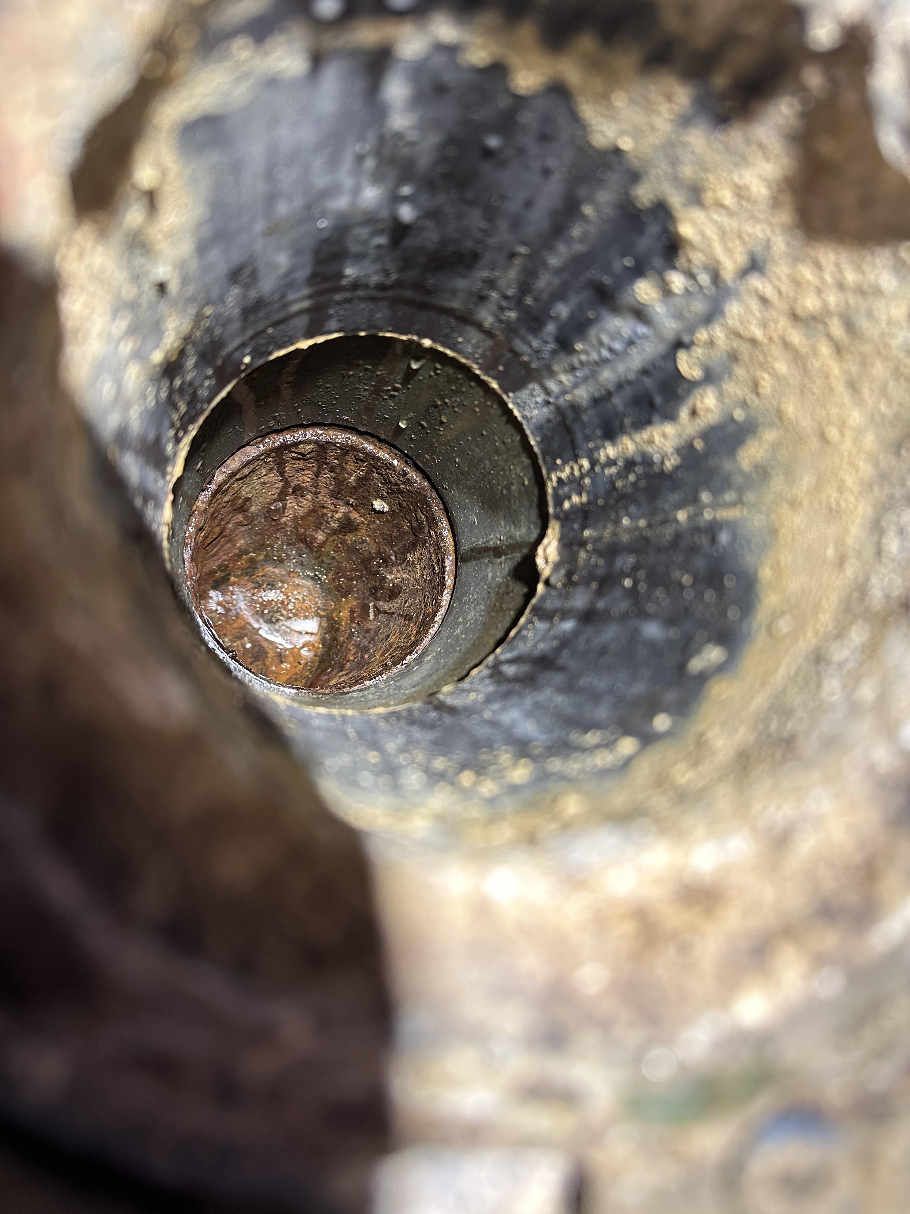

The lead sleeve was soldered to a brass coupling, which was leaded into the cast iron hub. All of that is out. I will clean up the hub and install a Fernco donut with PVC.
Does anyone know of a removable closet flange with a stainless steel ring? A push to fit/twist to fit/etc. I would like to use something that isn't glued in so there's future flexibility. The Sioux Chief PushTite 887-GPM fits the bill, but is being discontinued for some reason.

it looks like the hub ? use a donut with a piece of pvc and then glue a ring on it.
