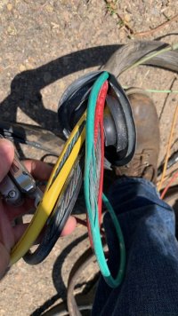

The well most recently (until this morning) housed a 2008-model year submersible 5hp 10gpm single phase motor/pump, piped uphill about 200' vertical rise to the 10,000 gal storage tank, with adjacent pumphouse. In pump house is a very large booster pump (also 5hp) charging two ~80gal expansion tanks, which then supply the house (including automatic fire sprinklers) and irrigation circuits. The fire hydrant is connected directly to the storage tank with a large-bore pipe. Aside from the well pump's integral check valve, there is another check valve at the top of the well (horizontal) and a third at the base of the storage tank at ground level just before the fill pipe climbs up to the top of the tank. Both inline check valves were replaced a few months ago after water hammer (I think) caused the PVC pipe to break just past the well and that first inline check valve. There is evidence of prior repairs to the pipe at that location.
Well pump stopped running and was found to be drawing very high current (up to 80A, intermittently tripping overload), so frozen pump was suspected. It was pulled today (very cool to watch!) with the following findings:
1) pump not locked, but has intermittently significant resistance to turn by hand.
2) several sections of galvanized drop pipe were corroded substantially, one with several small penetrations.
3) 2/3 flat submersible cable had water inside the outer insulation sleeve and also within the individual wire's insulation, with surface oxidation of the stranded copper wire inside - all four wires affected through at least the bottom 25', after which I didn't cut it open further.

With the single phase motor you will need larger, #2 wire. But it will be worth it as you will not need the troublesome, expensive, and sort lived VFD. This will make more difference in how long it last and how much it cost you then anything else. The VFD is a money maker for the pump installer and manufacturer, but that is not a good thing for you.
Notice that the pipe that was wrapped in pipe wrap or electric tape did not rust. It is time consuming, but you can tape all the steel
pipe that is below the water level. Pipe seems to rust the worst at the static level, as that is where it gets the most oxygen. Sch 120 PVC is great, as long as you use "double jacketed" wire, which is more expensive, but worth it. The torque from a 5HP, even with a VFD will wear the wire with the flex of the plastic pipe, Torque arrestors and stand offs don't help, double jacketed wire does.
