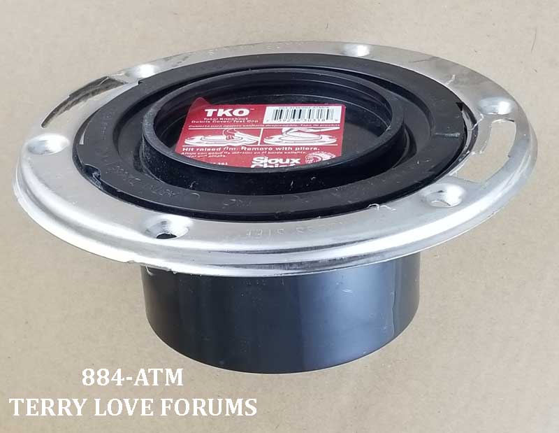

Yeah worst case you can fix anything if it breaks that's not really the goal. These break all of the time I know becuse I fix them. It's mostly due to someone bumping the toilet or leaning on it at a funny angle. If your willing to go with it then go with it.

Managed to get a Sioux Chief 884-ATMPK delivered within a reasonable period of time. So hopefully I won't ever have to worry about repairs.
