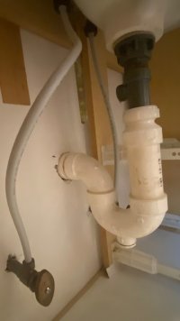

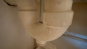

I am having same issue you had. Clog in kitchen sink. No nuts on p-trap. I have what looks like it could be a clean out on the bottom. There's what feels similar to a head on a screw (a little nitch) on the backside of the p-trap. Really hard to get to and see and not even sure it's a clean out. How did you end up getting yours off. Here's what mine looks like. Picture looks like you can actually grab the plug (if that's what it is) but it feels like an indentation (like a screw head). The whole mechanism is of course very flush with the pipe.
41,346
4,985
Your picture is not clear, but I think you are zooming in on something that is not removable. I think it may be like a datecode for the mold, where they rotate an indicator maybe once per month/day/shift so they can tell when the part was made.
If you want to know how to clean your trap, post a wider and sharper picture.
Try to include the bottom of the sink and where the pipe goes into the wall in the same picture.

Sorry about that. Here's a better pic.

Cecilia,
The trap you have is the type normally used in concealed locations, not under a kitchen sink.
You can easily replace it with a slip on joint trap, the kind you can remove for the purpose of cleaning or unclogging the line.

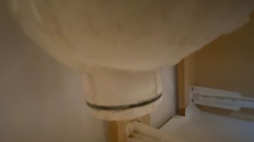

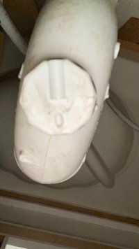

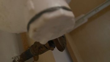

So grateful to have found this thread! Two things have fallen down the bathroom sink drain: the steel post from the drain-stopper (that rusted off and I've replaced) and an earring, but the p-trap looks glued shut, and it looks like there's a plug at the bottom of the p-trap curve but how can it be removed, please? Is this plumbing glued shut or can I twist it open somehow? Thank you very much for your help, in advance! Here are a few photos:

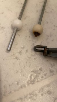

P.S. Here is a photo of the steel rod section that rusted off (and I replaced) from the drain-stopper, that's now caught in the p-trap along with an earring. Looking forward to expert advice out there on how to extract items from this p-trap (please see 5 photos above). Many thanks!

You would rotate the right side of that cap toward you, and the left side away from you. That is CCW when viewed from below.
