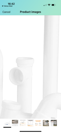

I couldn't use this as the tee? This to floor pipeP trap to this and then build up to attach the AAV?

No. You are supposed to use a sanitary tee. I suspect that pictured item is a baffle tee.
Also, I think all of that stuff is slip joint, which is 1.5 OD. The piping you want to hook to will be bigger, with about 1.5 inch ID.
