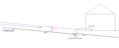

Hey everyone! First time using this forum so super thankful for any advice.
I am looking for recommendations and affirmation to a plan I have for getting water to my offgrid cabin (on posts) in Litchfield Maine. My property has a spring fed pond (beaver pond about 5 acres) on it and the spring comes from my property as well right behind the cabin. The spring is a seep rather than a stream flowing out of a hillside. I’m entertaining different ideas on how to best provide myself with the cleanest possible water consistently in the most cost effective way all while minimizing electrical load best I can so as to power it all with my solar system.
Here is my current thought process. While I could use the pond water and just use a sub pump in the pond this water would neither be the cleanest nor the easiest to tap into as the pond is 30 vertical feet below the cabin and about 300’ away meaning the trench that would need to be dug (I presume 4 feet deep to be below frost line) would be very long and difficult. Benefit to this system obviously being that the water is already there and collected so it’s plug and play once the trench is dug.
But my thought is that if I can find a way to collect the water from the seep right at my cabin that I would then have a very short trench to dig. I have tried hard to look up various ways to collect from a seep and it seems there are a few possibilities and I’m unsure which is best. One is to dig a trench across the area which has a slight sloping gradient but uphill of where the water is above ground parts of the year And using various sizes of gravel and plastic to deter surface water intrusion and an impermeable layer in the trench to collect and direct the water into a collection pipe. I suppose I would then need to have some sort of cistern downhill of this collection point to direct that flow into, which would need to be dug into the ground atleast 4’. And from there pump the water from the cistern (ideally sub pump so as to not be concerned with pump freezing) into a pressure tank in the cabin.
The other option I was considering would be to do a dug shallow well. When I was trying to locate the deep I dug a decent sized hole and it filled very rapidly with water. Probably 3 feet deep hole and filled to within a foot of the top leaning ground water is very high. Granted this was done in April meaning it could be lower in other seasons but I have seen moving water at the area where the water comes to the surface also in the winter and fall. So thought was that because of the high water table shouldn’t I be able to just dig a ditch as I had before but deeper (6’ or so) line it with a plastic well liner that is perforated at the lower sections and sub pump directly from there to the house? This seems it would be the simplest system but I haven’t found much on the use of a dug well within a seep area.
I apologize for this being long winded.
Other notes are I do not need this water to be potable. Just want to use it for washing etc. but if it happened to be clean enough that would be great!
Lastly, I will not heat the cabin 365 and ideally would like to use it and possibly rent it in all seasons meaning an oversimplified winterizing process would be great for when I or a tenant leaves. My current thought is this:

What is the topology like? Can you install a perforated pipe or a sand point horizontally below the frost line and have the water drain via gravity to a cistern that stays above freezing?
Unfortunately the seep is on a very gradual slope. If it were more hillside something like that would totally work. Frontline is 4’ where I live but I’ve seen water on the surface frozen here in the winter with flow just beneath so I think it stays liquid above frost line most of the time due to the flow.
This is the part that is so different from so many of the videos I see where others have a larger gradient to play with.
Out of curiosity what to you is the benefit of doing that over doing a dug well with say a 24” perforated corrugated pipe installed as a liner?

None really, other than digging a trench is easier than digging a hole. I also wasn't sure on your topology and the possibility of using gravity to your advantage.
I'm not a pro and the only experience I have is with my sand point at the cottage. We used to draw the water directly from the lake but I installed the sand point a few years ago to have "filtered", but not potable, lake water.

The difficulty will be in digging a 4ft deep trench or hole below the water table and not have it cave in on you.
Actually, this is kind of what I was suggesting, but instead of a trench filled with gravel to direct the water to a cistern, I am saying use a horizontal sandpoint or perforated pipe at the seep and a regular pipe to your cistern. If the seep flows all year, an overflow at the cistern would allow the water to flow into the cistern continuously. The slope from the sandpoint really doesnt have to be that much. I'd assume a slope similar to a drainage system (1/4":12") would be sufficient. And if there is a continuous flow in the pipe and cistern, it may not freeze even if not below the frost line.
Ah that may be true with regards to not needing a ton of slope and the point about flow making it less necessary for the frost line is hopeful. Can always test it this winter and edit it for next year if it freezes.
The main issues I see with this are 2 things. One, a sand point only hits a specific point across an area that is probably 20’ wide (unsure that will produce much flow?). This I think is why usually people dig a horizontal trench and place perforated pipe across the trench to collect the water and then those pipes come together into a main pipe going downhill and into a cistern. Two, if I’m already digging the hole downhill to put the cistern in I will inevitably be digging where the water starts to get higher and can sometimes be above ground during wet seasons. If I’m digging that hole for the cistern why wouldn’t I just cut out the perforated pipe ordeal and just put a perforated well liner in the hole for the cistern and pump directly out of that?
Also could be hard digging where the water table is so high?
That would work of course. Sort of like your septic leach field in reverse. Unfortunately, I don't have enough experience to say whether that would be more advantageous than a single pipe. I guess it would largely depend on the soil permeability and how deep the pipe sits below the water table. Nature abhors a vacuum. So whatever water flows into the pipe will be replaced by the surrounding water. From how far and how quickly would depend on those two factors above.

Good food for thought. Another concept to consider though would be that it’s possible/ almost certain that the water table changes a bit from season to season so another advantage to a vertically dug well is that it’s more likely to be within the water table range for all seasons whereas if the sandpoint could be perfect for the season it’s set in but too close to the surface for the driest spell.
I suppose October (when I’ll be testing this) is usually on the drier side as compared to spring so it’s a better time to get a rough idea of where about I should be for the low point of the water table.

Logistically how would I drive a sandpoint horizontally anyway? I suppose I would dig down deep enough to stand in the hole while sledging the sand point at a slight upward angle? Or better to just dig a trench to lay the sandpoint into and then burry it (maybe lay some rigid foam insulation ontop of the pipe 16” overhanging either side to help in insulating as well?)
Yes, that was what I was thinking. I only suggested a sandpoint because it is a manufactured perforated pipe with a screen. But a perforated PVC pipe with some filtering material would likely work too.
