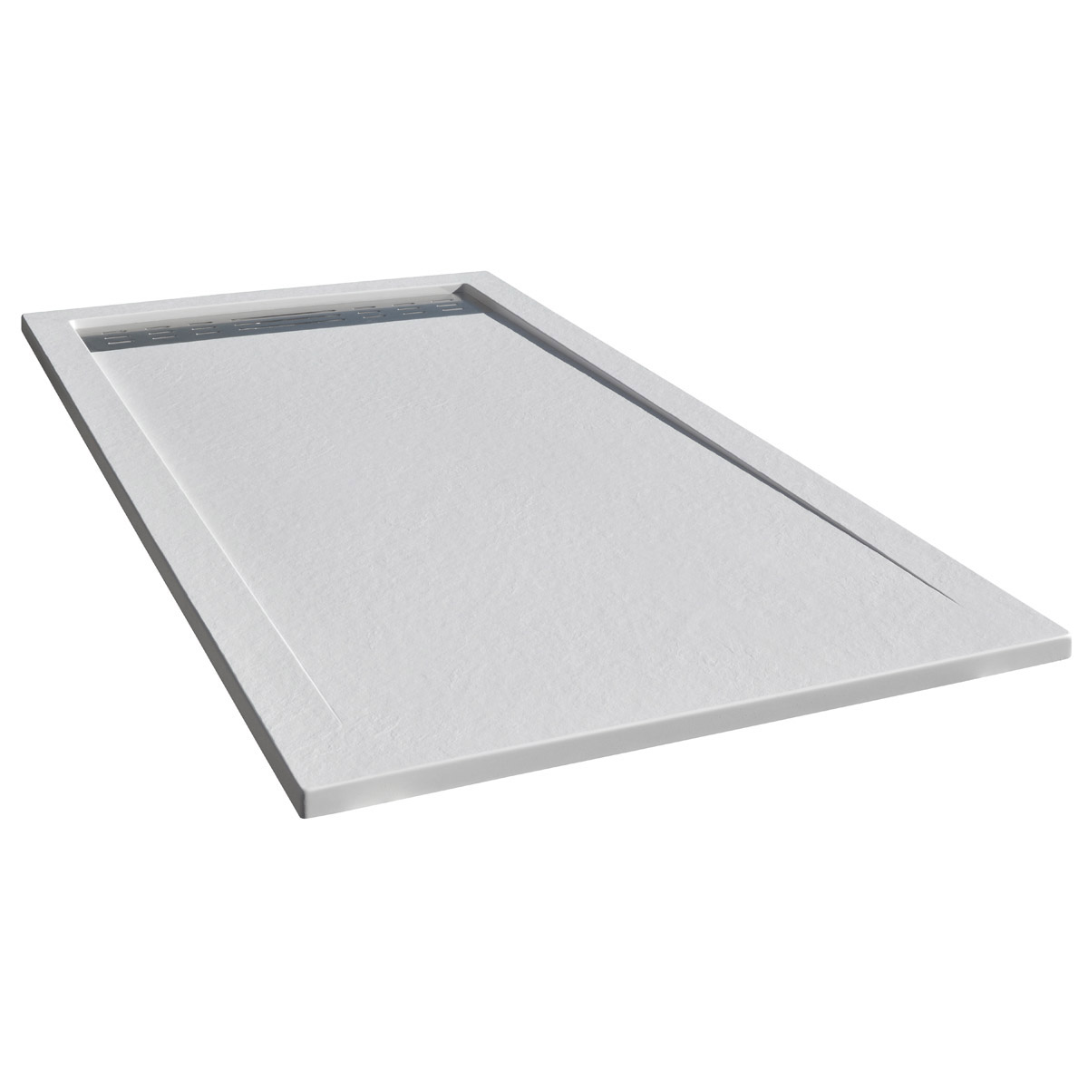

I am at a lost on what the best option would be for my new walk in shower project. Dimensions are 99'' x 37''. Wife does not want tile anymore so I am looking at getting the below pan (36'' x 79'') and then taking up the rest of the space with a built in bench. Since my shower has a 31'' wide opening (doorway) into the shower (walls encompass the rest of the shower), i am confused as to how i would make this pan work with a glass shower door since the pan will sit inside of the opening. I haven't yet decided on if I will install the pan flush to the outside finished floor or install on top of the subfloor in the shower.
Any tips or help would be greatly appreciated.

Take the drywall off of one side and probably some studs need to be taken down temporarily. Without doing this is almost impossible to set a pan that large. It can be done but you'd need some kind of pulley system, lol.
Maybe I'm not clear on your question, what does the door have to do with anything?

Looks to me like the pan is not made at all for this application the door is on the side of the pan not where you are supposed to walk in at all

sorry about the confusion...yeah the pan is only 120 lbs and at 79'' in length i will be able to stand it up on end and slide it into the shower stall. I will be constructing a curb and the glass door will sit on the curb. I will be going with some type of acrylic/plastic/pvc wall panels. To take up the rest of the space in length (approx 20''), I will be constructing a bench.
Concerning the backer board, since i will not be going with tile, what would be your suggestion?

People like cement board, I'm a a hardibacker person.
However most wall panels for showers nowadays claim they don't need a special backer and plain drywall is OK. At a minium I would use the green water resistant drywall.

So now I am at a lost due to the shower tray I was going to order is not available from the company. (they do not have anything in stock larger then 72'' in length). With my shower stall being 99'' in length does anyone know of a shower tray/pan company that offers these in lengths of 80'' or more? It seems like over in europe these are pretty common but here they are hard to find. i did price out a custom acrylic shower pan, but that would run me over $3,000. tile is not an option, so i am scouring the internet trying to find a pan that would work

I dont think it would work anyway you want walk in with no curb Is how I understand ? custom pan sounds good othe than price

There isn't a shower pan made in any size out of acrylic that is worth 3,000.00. It's literally the cheapest, thinnest and has the lowest life expectancy of any available choices.

99" is lot , I would consider just closing down the 99" part to whatever the biggest size is that you can get.
