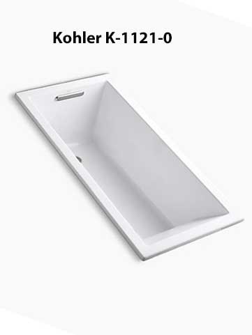

New install of acrylic Kohler 1121 seems unstable on its mortar

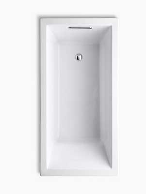

I am building a new undermount tub and have followed the relevant threads on this forum, which correctly point out that there are no specific guidelines about how to go about this. So I built a nice 2x6 frame such that the tub's lip will hover about 1 inch over the 2x6 frame. My thinking here was that once the tub was installed I would slide in various strips of plywood (1/8, 1/4, 1/2) to further support the tub by the lip -- and continue to build it up so that the final picture frame deck (made from either solid surface or quartz) would be super strong.
I brought in a licensed plumber who fabricated the drain connections and embedded the new tub with mortar, which was poured on a sheet of 10 mil plastic. It was all level and we filled it up, squishing the mortar between the bottom of the tub and a sheet of 10 mil plastic. After leaving the filled tub alone for a couple of days to allow it to set, I was surprised upon draining as to how unstable it was. I can make it rock back and forth a tad and the tub+mortar+plastic was easily moved about a 1/4 inch so as to better align my center marks.
So what gives? Is this common? Should I mix up some more mortar into small bags and slip them in so it doesn't rock? The 4 tiny feet rest on my level subfloor OK.
Do I ask for a redo or should I continue on with my plan to beef up the underside of the lip with strips of fir or a good grade of plywood. Do I screw the 2.75 inch wide lips into my 2x6? I haven't seen any mention of screws in forums or in the Kohler instructions. Using screws seems reasonable; if this was an alcove mount you would screw the vertical lip into the studs.
Many thanks in advance!
