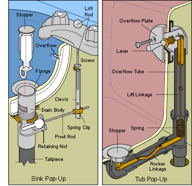

Making the side hole larger was not necessary. The overflow built into the sink basin surrounds the drain pipe so overflow water can flow from anywhere. Notice below the white channel goes around the drain.
Have you tried the drain without the stopper? Did you remove the trap completely and clean it? With the trap arm removed eyeball the drain pipe with a flashlight. For bathroom sinks clumps of hair is usually the culprit.

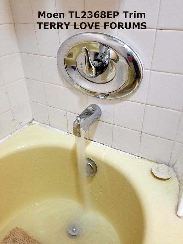

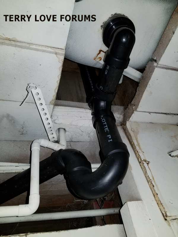

I replaced this tub drain yesterday and replaced the bathroom lav and faucet. All tied together.
When I tested the bathroom sink, water came up in the tub. The homeowner said, "Yes, it's been doing that when we drain the sink after brushing our teeth."
Looks like I will be sending my friend Walt in to do some snaking.
Pulled out an old three handle valve and replaced with the Moen Posi-Temp and a TL2368EP trim.
Tuttles Revenge
4,459
1,575
We can see old Durham cast iron threaded fittings.. Very likely the drain is clogged and just as likely the snake is going up the vent when it hits that terribly constructed Durham san tee.
