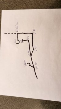

To start off I'm a Journeyman Plumber in Colorado and have been plumbing for 5 years. I've only worked for 1 small 3 man company with a 20 year master as the owner but have recently switched to a slightly larger 5 man company. The nice thing is I'm around new ideas and ways of plumbing, however sometimes some of what they are saying or doing looks a little off to me. Which brings me to this 3 piece bathroom group in question.
At my previous company we always had our bathroom groups that were horizontally wet vented come off the toilet, which would be the furthest downstream fixture in the group. I have been refreshing my memory with Chapter 9 of the IPC recently, and with commentary, and I cannot find anything that states the toilet has to be the furthest fixture down stream. That's easy enough to understand but the commentary has me wondering if the way the fittings are arranged in this bathroom group are incorrect. I will attach a picture. My thinking is that the 3x2 wye they used to pick up the toilet should of been a straight 3 inch wye with a 3x2 bell reducing coming out the end to pick up the lav.

I NEVER had to MAKE the toilet the last fixture, unless that was how it worked out. The shower drain is incorrect because it must have a vent before it enters the main, in your drawing. I would have done the system several different ways from your drawing.

I'm pretty sure the ipc requires that a lav or shower be the most upstream fixture.
These are some permissable ipc wet vent configurations. They all have a lav or shower or bath upstream of the toilet.
I think if that toilet had a dry vent your drawing would be legal as the ipc let's an individually vented fixture connect to the wet vent.
For the IPC (or the UPC in Washington, which amended away the "WC must be last" provision), the horizontal wet vent shown in the OP's diagram is fine. The 3" line you call the "main" is still the bathroom branch carrying only drains of the bathroom group. Your comment would be correct if a non-bathroom group fixture were joining that 3" line upstream of the shower.
For the purposes of fixture connectivity and wet venting, there is no upstream-most fixture. There is only an upstream-most joint at which two fixture drains connect. One of those fixtures must be the dry vented fixture that is providing the wet vent.

I think ipc allows W/C last but dosent require it.
