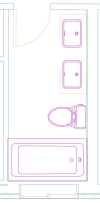

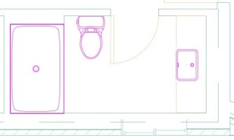

I have 3 bathrooms under remodel, shown below. 1 with tub/shower combo, and (2) 3/4 baths. My wife picked out this hansgrohe Unica Raindance handshower wall bar (not yet purchased) and these Hansgrohe Ecostat Classic 2-zone trims with volume control and 2-zone diverters (already purchased)
The West and East baths already have the iBox plus valve rouged in dead center, West CL 36" AFF, East CL 45-1/2" AFF
We were planning (names on attached pictures):
West: Tub and Handshower only
East: Handshower and Ceiling Rain Shower
Studio: Handshower only.
We think the hand showers are essential for cleaning the bath, washing dogs, etc. and in general convenient. So, we want them.
My concern is that putting that wall bar centered over the centered valve (in 2/3 of the baths) will have the hose dangling in front of the valve.
Is this hose over the valve/controls an issue?
Do you think the above proposed configurations are odd or a mistake? If so, should I be considering:
West (young kids): Add 2 or 3-way diverter valve and then have Tub | Traditional Shower Head | Hand Shower, possibly rain shower at ceiling
East (guest bath, including grandparents, who at some point may need to sit on a bench in shower): Traditional Shower Head | Hand Shower
Studio (rental): Traditional Shower Head | Hand Shower
We haven't had a rain shower previously, so don't know how much we would use, or if that is a good idea over an apron tub that may have a fixed pane of glass and no door.

Usually the slide bar is just to the side of the controls and water outlet (somewhere around 2 o'clock or 10 o'clock) Mainly due to height and ergonomics.
Three shower heads in one shower is a bit much (and not code I believe). Sometimes there are modules designed with multiple shower heads but they don't output as much water per head.
I think I would omit traditional shower head and do rain with slide bar. To have a slide bar and traditional shower head is just two things doing the same thing.

No. That's how they are setup mostly. Maybe 1 o'clock would be more to your liking but three showerheads at 2.5 gpm isn't legal. Drains are only so big.
Besides the slide bar should be removable so one could remove the chrome shower 90°, return it to a shower spout and return to a traditional head.
Where were you planning to put the outlet?

Definitely not planning on having more than any one water outlet running at once. I would be using a valve that switches between the various devices, such as this three-way Hansgrohe diverter valve, which allows only one outlet to run at a time. They also make this version that has 3 outlets, and you can run up to two outlets simultaneously, but I don't think the local AHJ will allow it. We are under watersense requirements. I have 1/2" copper supplying the valve.
They also make the same valves in two-way diverters that could be used be used for a shower head and a hand shower. That may be the best route... so the original valve selects between tub and secondary diverter valve, and the secondary diverter valve (mounted above iBox selects between hand shower and main shower head.
Is the overall approach (main valve operating tub or routing to a secondary valve) OK, or should the main valve be different in this case? I
Good question on the outlet. I was thinking the outlet for the hand shower would be 32-48", and placement would depend on if I add a second valve and shower head or not. I am thinking below the valve is best, provided the hand shower is offset from centerline. That way, the hose is long enough to reach the other end of the tub when cleaning, washing a dog, etc. I have a lot going on in that wall... non-traditional framing, gas supply for clothing dryer, supply lines and drains for washer, etc.
Glad to hear your thoughts on all this.
EDIT - had to go look. I actually ran the hot supply in 1/2" copper. It was the washer that had to be run in pex... long story.

Related question... in the guest bath (east) there will be a corner bench near the entry. Grandparents may often use this one, and possibly want to sit. Assuming it has some sort of shower head (rain or normal) and a hand shower. Is it best to keep the hand shower wall outlet near the main controls with a longer hose, or a bit closer to the bench?
John Gayewski
5,090
1,645
Iowa
I did a handicapped shower for my gf's parents. Her mom wanted the slide bar on the longer of the three walls facing out. So right when the curtain opens the shower is blasting outward into you and the floor. I always thought that was silly, but it was closer to the bench and that's what she wanted. Now since the husband died the son is the only one who uses the shower. Floor is always wet.
So I would say do what makes the most sense. Sprayers have attachable "halos' (is what we call them) that can have multiple receivers hung on the wall. So you could theoretically hang a sprayer anywhere and in multiple different spots. While still having the slide bar in a more traditional spot.
